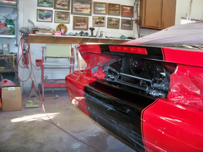

i have searched numerous local parts store. i am looking for the third brake light bulbs for the brake light in the spoiler. any help would be appreciated.

Checked a Napa yet? I just bought 4 of them on tuesday for my 88. I don't know why any other part store wouldn't have them. Are you asking for a buld for the third brake light? Or are you taking one with you? If you're asking...thats most likely your problem. The idiots they get to work at most parts stores can't tell the differance between a headlight and tail light (bulb).

i know what the bulb looks like, i just don't see any on the shelves. maybe i have to ask??? what was the part number, do you remember? i looked in the book and i believe it is 891

http://www.bulbtown.com/891_MINIATUR...BASE_p/891.htm
i do believe this is it....little buggers are expensive!

http://www.custom-leds.com/
Way less expensive than even a single bulb for the spoiler.

If for the LED kit, it's just the LEDs that plug into the same socket as the normal bulbs. Should also have a resistor or current limiting diode to splice into your harness. I bought mine when he still had a deluxe kit and it came with a prewired harness, with the necessary component, which installed between the stock harness and the bulb assy. It comes with the necessary instructions which are easy to follow.

Do you have a Home Depot close by? Check the outdoor lighting aisle. Look for replacement bulbs for Malibu brand lights. The ones you want are the 10-watt sized bulbs.

Radio shack was the only place in town I could find mine other than going online.I like instant gratification if at all possible

Radio Shack, 20V halogens for $1.99 + tax, or better yet buy the led kit.

go to radio shack part # 272-1177 , your wallet will thank you . 2 bux there , 6+ bux at advance . good luck .
