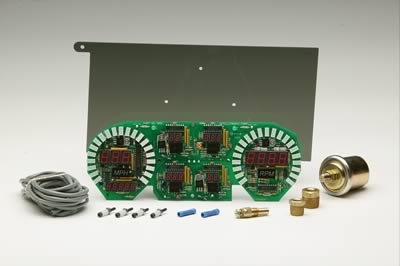

I have gone through multiple OEM gauge clusters just trying to get something working, and I am just about through with that. I may have an opportunity to pick up some new gauges. Looking through the web and Summit, I see that we have a few different options.
The covans Classic gauges
http://www.covansclassic.com/parts/d...0424.175.2.129
Dakota Digital gauges
http://www.dakotadigital.com/index.c...prd_zm_168.jpg
http://store.summitracing.com/partde...5&autoview=sku
and these Nordskog's
Last option is to piece together some autometer gauges individually.
So my concern is the wiring on each of these systems. I like that the Dakota digital has a hub for all of the wires, but what about the nordskog gauges and the Autometer gauges?
Is it cheaper to piece together some Autometer gauges and would they be more reliable than the dakota digital (over time) ?
I am hoping someone else has had this debate or has taken this path. Any input ?

I felt the same way honestly, I didn't want any of the hassle, the dakotadigital gauges are starting to look "worth it"

Well I figured I would post an update. My question was answered, a friend (a very good friend) got tired of me fiddling with my old gauges and he actually ordered the Dakota Digital gauges for me. (He is a blessing)
The control box from dakota digital allows you to run all of your lines to a remote location rather than trying to fit all of that junk behind the gauge cluster. I would note that their is minor modification needed to the stock IROC gauge housing assembly that is not mentioned in the instructions. Their is a hollow column inside the assembly that will need to be dremelled out before it will fit properly. Otherwise, the install was relatively easy.
It was a challenge getting to the oil sending unit to replace it, but not at all impossible, and the water-temp sending unit on mine was on the front of the manifold.
I ran new wires for the oil pressure and water temp sending units. (although I I did splice in the stock connector for the water as i thought the ECM might need to know whats going on with the water temp)
It has many cool features, 0-60 meter , quarter mile time, odometer, high speed, high rpm etc.
Verdict: Worth every penny
