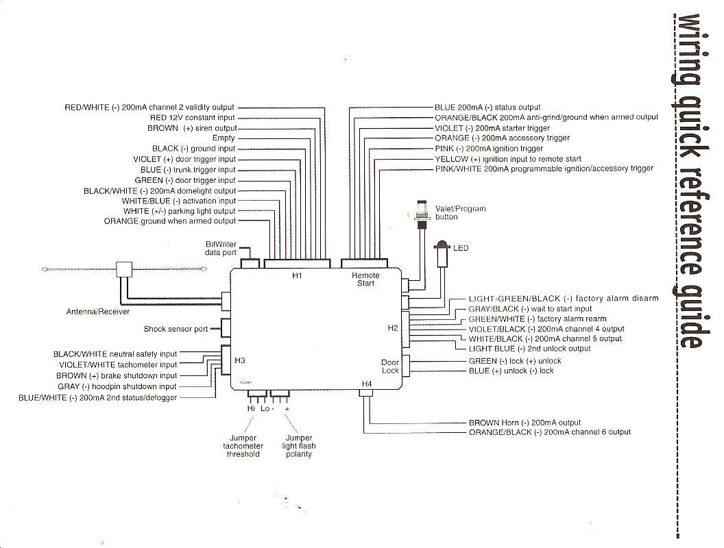

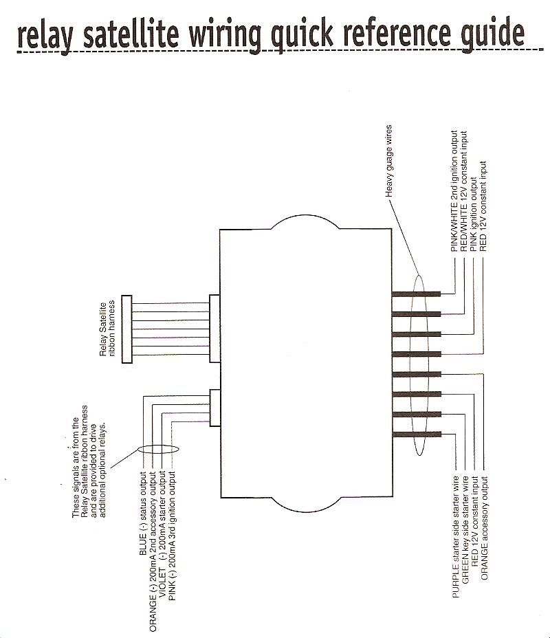

i found the wire. attached to the distributor. I had the unit learn the tach and still nothing. Im stummped right now. everything thing else works. the alarm, keyless entry. .... Now if i could just get this remote start to work ill be all set.
The thing that gets me is ... the ignition is suppose to turn on first (guages and lights come on and stuff) and then attemp to start. But Nothing is happening at all when i hit the star button twice or ever three times. Ive check voltage on all the wires.

Originally Posted by afremont
How does the remote start bypass the ignition switch and VATS? The VATS system will completely disable cranking the engine unless it's happy. I don't think it would keep the the dash from powering up though.
When i got the race chip i had the vats turned off. Ive tried it with the key in, key in and ignition turned on, and no key... i get nothing
Attached Thumbnails Python 990 Install-python-990_3-001.jpg   Python 990 Install-python-990_3-002.jpg

Old May 25, 2009 | 12:08 PM
HCR13's Avatar
Joined: Dec 2006
Posts: 2,212
From: Augusta, Ga
Car: 1987 Trans Am
Engine: 355ci L98 soon to be turbo'd
Axle/Gears: 2.73 posi
Re: Python 990 Install
the tach signal is on the coil, not the distributor... Honestly, I'd go back and check your wiring. There is a wire thats only hot when the key is the crank position...
