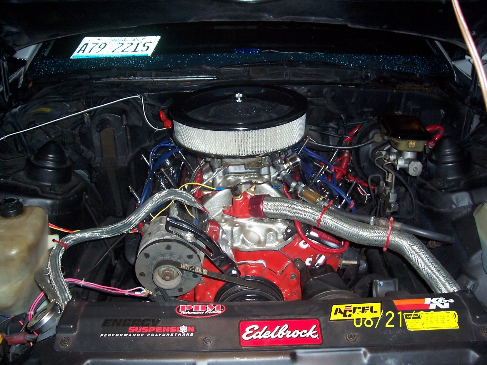

Fan/relay/switch/Trans temp gauge install
Installed dual 14" fans on the radiator (They don't fit perfectly)
installed a 10" fan on the trans cooler
radiator fans are controlled by a 180 degree thermo switch
trans fan is controlled by a soft switch and relay
Trans temp gauge is an Autometer Phantom electric
also wired (it was already there) a blue LED floor light
fixed the ****ED oil press gauge (someone crushed the line by tigntning it too much)
Not bad for an evenings work!
