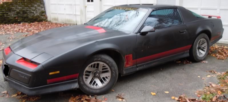

I found my problem. It ended up being the turn signal switch. I believe that when I took my steering column apart I pulled a little too hard on the turn signal switch to get to the bolts that tighten up the steering column. Here is a pic of what I found. I noticed that the light blue wire was completely out of the switch, the dark blue was coming out and the brown one fell out while I was removing the cover to see all the wires. please note that if you are looking at this picture trying to figure out your own problem that this view is under the black plastic peice that is under the metal holding bracket.
