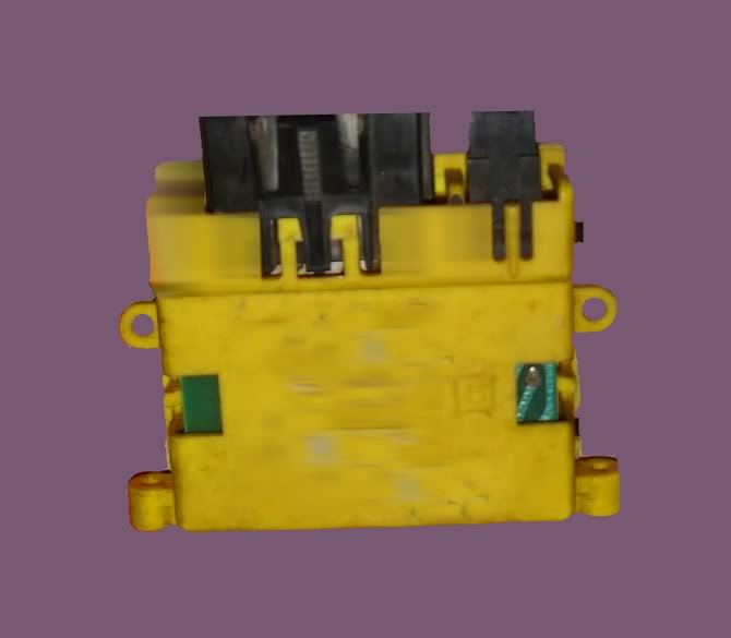

If your odometer also does not work, it might be the Vehicle Speed Sensor.
Gain access to the buffer which looks like this:
It’s located behind the IP on the right.
Connect an audio amplifier to terminal A
yellow wire to make sure it’s getting a signal.
Ground to ground, the signal wire to terminal A
yellow wire of the VSS.
With the car on jackstands listen for a hum from the amplifier when the rear wheels are rotating.
If you do, then find out if you get a hum from terminal C
tan wire.
The
tan wire then goes to the speedometer unit.
If it gets to the speedometer but the speedometer does not work, have it repaired or replace the unit.

Originally Posted by james.gould150
can you give a detailed step by step and what tools and what to test?
Follow the procedure in post #2.
my trip meter/odometer arent functioning? bad guage maybe?
Those are also dependant on the VSS.
