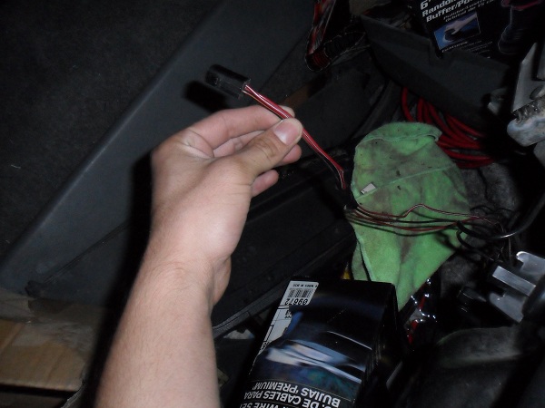

remove the plastic cover it should be attached to the contacts in order to power it when you hit the brakes i beleive its a pigtail w/ 2 or 3 wires, should be around all your hatch motor wires but should be attached to the contacts. my interiors gutted i removed the hatch motor and wires snapped a couple pics for you, the wires im holding is where your wires should be connected. if they are connected it could be something else. the contacts may be clean but if theyre not making a good contact they might not light up
