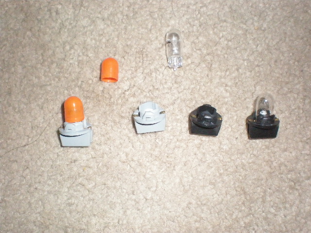

What sockets are you needing? Pic? Only instrument 194s I've seen use separate sockets, not a combined bulb+socket in one.

I've got lots of extras of those from 90-92 clusters. Get in touch
