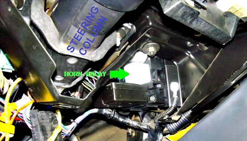

You won’t feel a *click* from the horn buttons, they’re Sof-Touch buttons.
To find out if they’re good remove the knee bolster.
The relay is to the right of the steering column.
Use a voltmeter to probe pin J on the relay.
When you press a horn button the voltage will go to zero if the button is working.

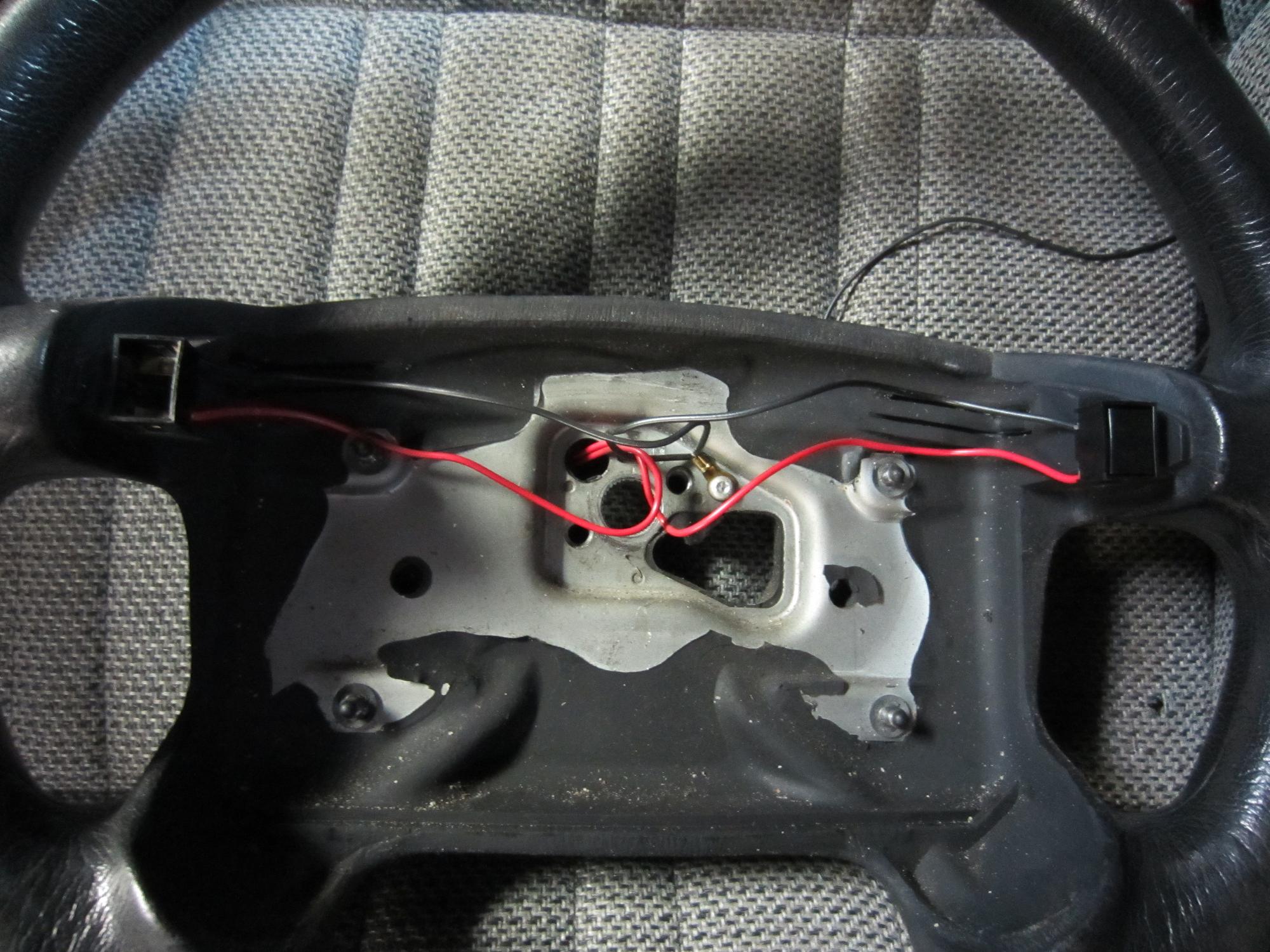

Hey, reviving an old thread.
I finally got around to taking another look at my horn. I replaced the relay a while back, but that didn't fix the problem so I took the steering wheel apart and found this.
One of the buttons is missing and the other is just flopping around. Is there supposed to be a spring or piece of metal that keeps the buttons from being depressed all the time?
Also, should there be a current coming from the red wire?
Thanks

red wire should have a constant 12v. when you press the horn buttons it grounds the circuit and sets off the horn. sounds like both horn buttons are broke

Yeah, both are broken and there's no current running through the red.
Guess I'll have to pull apart the rest of the column
