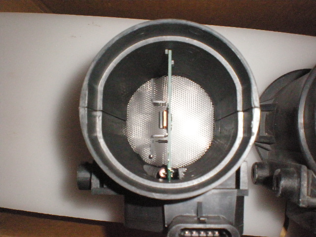

I got one from Autozone & actually turns out it is a (slightly) higher CFM flowing circuit board design vs the stock Bosch cooling fin & wire element one.
http://www.autozone.com/autozone/par...mString=search
Attached Thumbnails Engine run with MAF disconnected?-pb090003.jpg   Engine run with MAF disconnected?-pb090004.jpg   Engine run with MAF disconnected?-pb090005.jpg

The MAF tries to keep the heated film or wire (wire in your case) at a constant temp of 70*C. As air passes over the film or wire, the wire is cooled proportionally to the density of air passing over it. This is how the MAF obtains the "mass" of the air.
Now, the reason for the hot wire MAF's burn-off circuit is due to the small particles of crud that make it through the air filter. This crud coats the hot wire or film as air passes through the sensor. The burn-off function is used to burn off the crud that's built up on the wire to clean it off and restore proper function, similar to a self-cleaning oven.
If the burn-off circuit fails, the crud continues to build. As the crud builds up, more power is required to heat the wire to optimal temperatures, and the output voltage rises. As the voltage rises, the ECM is signaled that more air is passing through the sensor than is actually passing through the sensor, so more fuel is sent to the cylinders, enriching the fuel mixture. This will cause a code 45 (rich mixture) if it goes on for long enough, and may potentially set a code 33 for the MAF over-reporting the airflow through it (although this hasn't happened in my case).
So, yes, the failure in the burn-off circuit probably killed your MAF. You may have been able to use a MAF sensor cleaner to restore functionality, but it's too late now.
