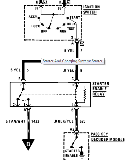

Per the following images, use a solderless splice, a bit of wire and an eyelet terminal to ground black with yellow trace #625 in the first diagram, and dark blue #229 in the second to a good chassis ground. Chances are, there's a wire screwed to the floor or firewall near here anyway, use that. This will bypass VATS on both your starter and your fuel pump, as all it does is ground these circuits when the correct key pellet is inserted and the key is turned to start.
Full disclosure: I haven't done this yet, I'm going entirely on the diagrams to figure this out, but I'll be doing it on my car in a few days when I get my new steering column.

Ok, so after some further research (read: I got schooled by BigBadLou!) Grounding the first wire will enable the starter, but cranking fuel won't happen, so I found this kit that's meant for doing engine swaps for VATS dependent PCMs to enable the cranking fuel without a VATS module hooked up.
http://www.summitracing.com/parts/PRF-64024/?rtype=10
Thanks again to BigBadLou for pointing out my error, much appreciated.
