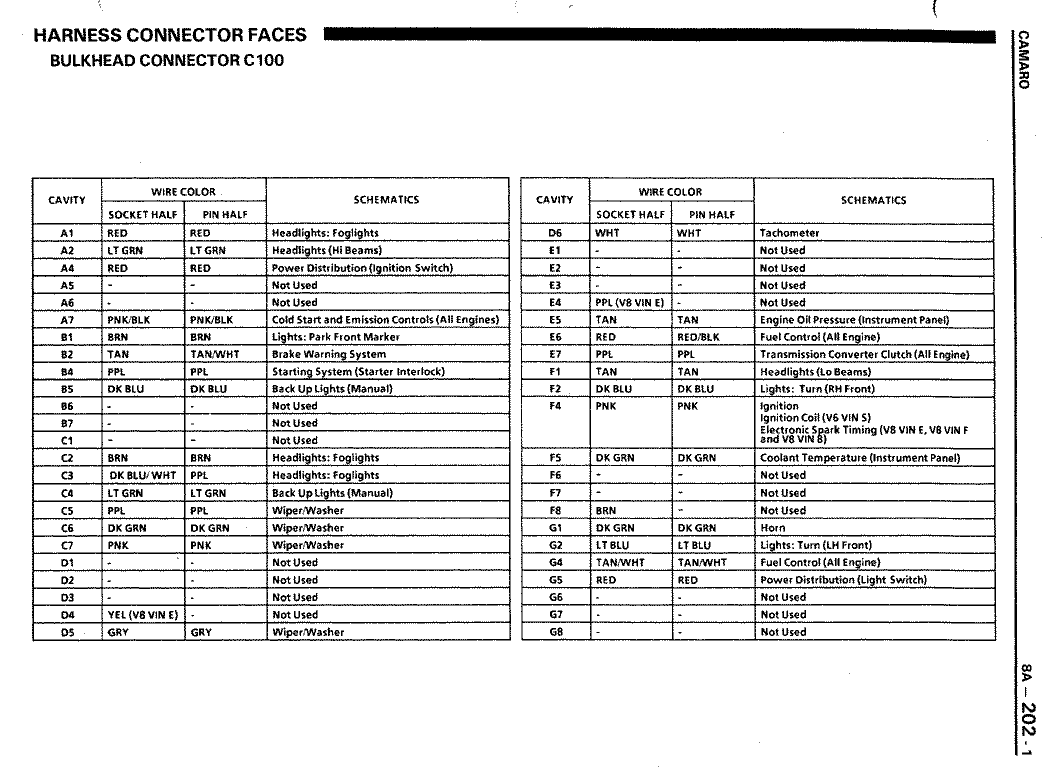

I'm running a Current Performance harness and need some help with hooking it up to the C100 connector. Here is the pinout:
https://www.thirdgen.org/forums/atta...89-89c100a.gif
Is there a wire out of the c100 which gives a cranking signal? This is used to feed power to starter relay in the harness. Would this be B4 (Starting System)
The harness has its own fuel pump relay and it is used to supply power to the pump. Is there a connector on the c100 that directly goes to the pump, or should I hard wire it right to the wire from the tank. I see that E6 and G4 are for fuel control.

Yes, the B4 is the thick starter wire that carries tens of amps to the starting solenoid. It would be hard to splice into it. Instead, I recommend using the CRANK fuse in the fuse box. It carries the same signal, just fused to 3 amps.
Yes, the tan/white on G4 is your fuel pump signal. It continues from the C100 under the driver side door sil to the back of the car where it exits the passenger compartment behind the rear seats and plugs into the fuel tank connector.
