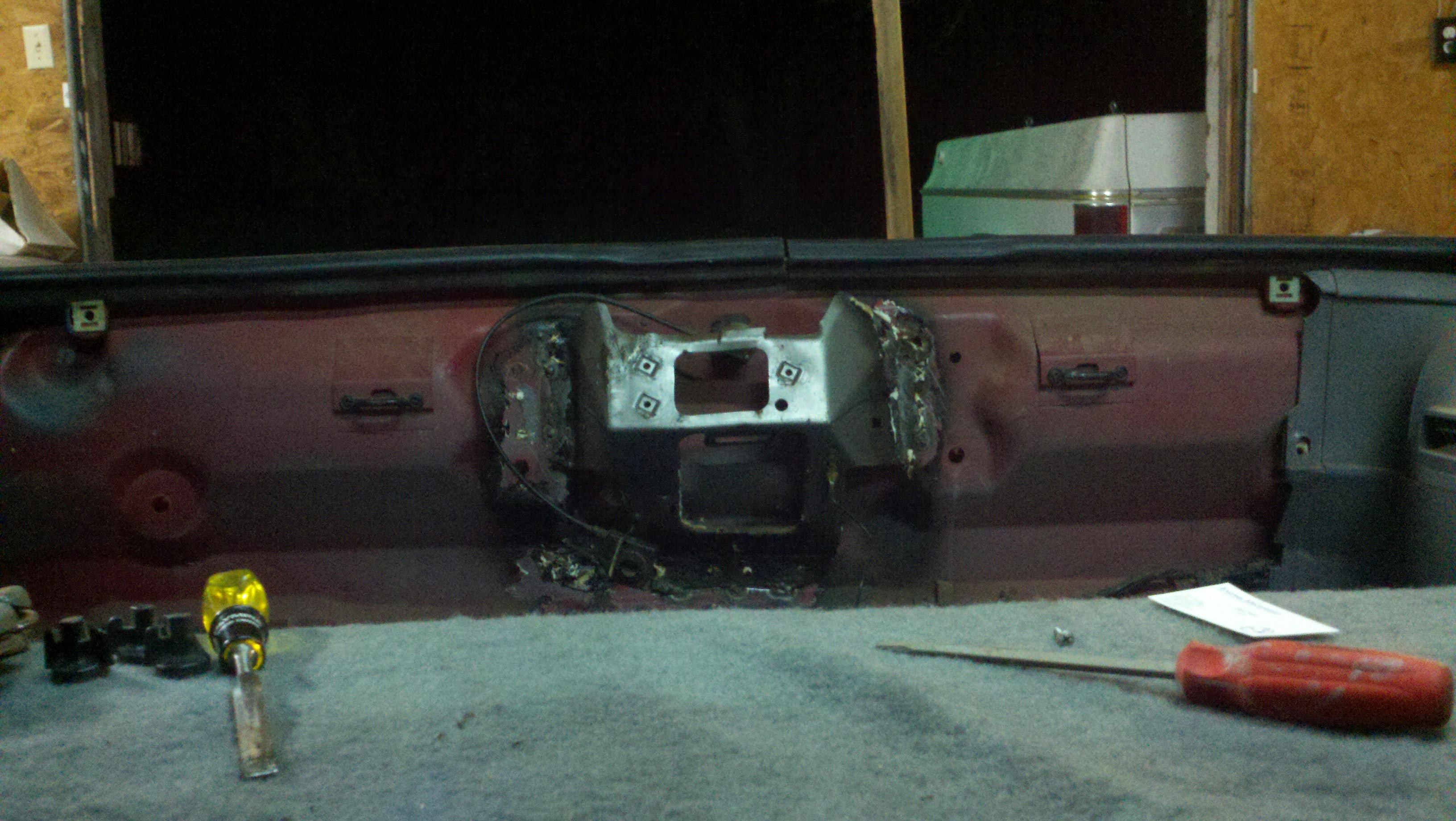

I am currently in the process of restoring my 91 RS and am in need of some insight. Right now I just have a manual latch system for the rear hatch and want to install the motorized version. The previous owner has goobered up the bracket he installed. My question is where are the mounting holes for the new bracket assembly (pics attached).

OMG. I am so sorry for you. You'll need to rip all that out and weld in the mounting bracket from a late 91-92 car. Those years have a pull-down with a tan-colored molded plastic frame.

He will need to determine which came with his car, the early 91, or late 91-92 setup before doing so.

Lonsal is correct. I just did this on my '84 Bird. Converting from non-motorized to motorized. I found a motorized unit out of an '89 formula, drilled out all of the spot welds, and rewelded it to my bird. Not to hard of a project but drilling spot welds sucks. Good Luck

Again, OP before jumping into what wont work, because your car is a 91 you need to first determine which hatch motor your car came with factory, then get the appropriate bracket.
And to answer your question about the holes for the bracket, there are none, the bracket is spot welded to the body from the factory.

The tail panel that the taillights and lock cylinder attach to is different on the late 91/92 cars the lock cylinder is in a different location.
So no, you cannot just swap the bracket and be done, and I wouldnt put the spot weld drilling down as a small feat either, there are a LOT of them.
If you havent got the hint, i've done this, or rather attempted it, after drilling out every one of the spot welds on the early 91 car to remove the bracket, drilling all of the spot welds to remove the bracket from a 92, and then using rivets to install it in place temporarily to hold it for welding, discovered that the lock cylinder isnt going to lineup and allow the motor to bolt up, and it would have to be relocated if this were to work.

It interfered with bolting the motor on (the lock cylinder), so i'm guessing they redesigned the whole back panel to relocate it, not quite sure how they didnt just design the new setup around it.
Technically it can be done, you'd just need to get a section around the lock cylinder from the back panel, carefully cut out the original and weld it back in.
I just called the waste of time a loss then, and put the earlier 91&earlier bracket back in the car.
