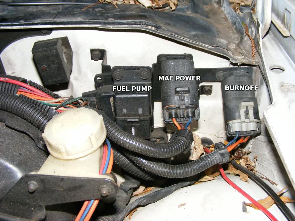

Can anyone tell me real quick what these three relays are for and the box behind them?? 1989 Iroc 350TPI.

The lage piece on the bracket is the esc module for knock retard control.

The box is the esc it work with the knock sensor to retard timing , all this can go in the swap. I assume gm placed it there unlike tbi trucks on the intake due to the lack of room on the intake.
