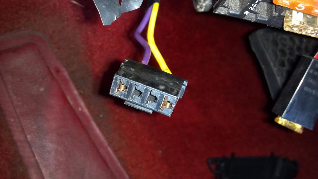

Im troubleshooting a cranking problem on a 1988 TBI 305/auto Trans am, my first question is does this year have VATS? Also is this a neutral safety switch for a manual? i found it under the dash..

Yellow and purple are definitely starter wiring ;
you could try jumpering that connector to see if it fixes your problem

I tried to jump them but iv got nothing trying to turn her. over

Im starting to wounder if thats the case... the previous owners before me said they swaped in a new steering column and it woudnt start so they put in a new ignition cylinder still woudnt start... now its become my problem, something else that iv tested was there is no draw what so ever on the battery when you are turning the key forward to engage the starter... iv only looked at this issue for a couple hours the last couple nights i had a buddy help me last night with both think its something easy...

Turns out it was just the starter...
