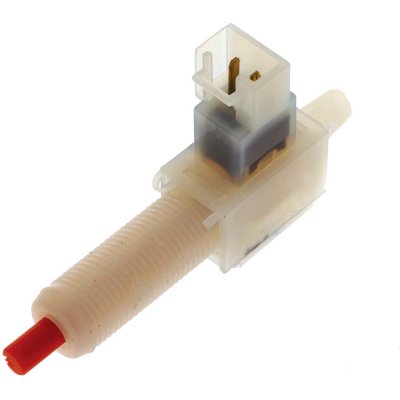

Recently swapped a t56 in my car and went to the JY and picked up a spare vacuum switch from another 3rd gen w/ cruise.
I put a "T" on the vacuum line and ran it to the 2nd switch. Also wired the plug in series with the original vacuum switch.
Depressing the clutch does not deactivate the cruise settings, however it releases the throttle (wont redline the engine). When the clutch pedal is released, the cruise goes back to its previous settings (MPH goal) and all is well.
I am really pleased with how it works, you can shift gears without having to deactivate the cruise.
Does this sound about right or did it work differently from the factory?
I only ask this questions because I had thought that it would disengage the cruise totally like pressing on the brake pedal.
This is the switch I used
