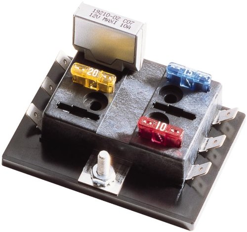

I want to add some additional electronics to my car. I would like to add additional circuits which will be 12 v Keyed. I was wondering if it would be safe to run a wire with a male spade to an aux fuse box from the factory box under the dash. (Attached what I have in mind below.) I then would run the additional electronics off the Aux fuse box.
I wanted to run 2 -3 Autometer Gauges, and 1 or 2 12 volt Aux Fans in the interior ( no longer have AC in the car.). The draw of all of the above items should be less than 20 amps.
If this isn't a good idea can you suggest something else?

i would take the brown wire that fed the a/c blower and use it, should come from 25A htr-a/c fuse
http://austinthirdgen.org/mkportal/m..._continued.gif

Ok thanks, i'll give it a shot.
