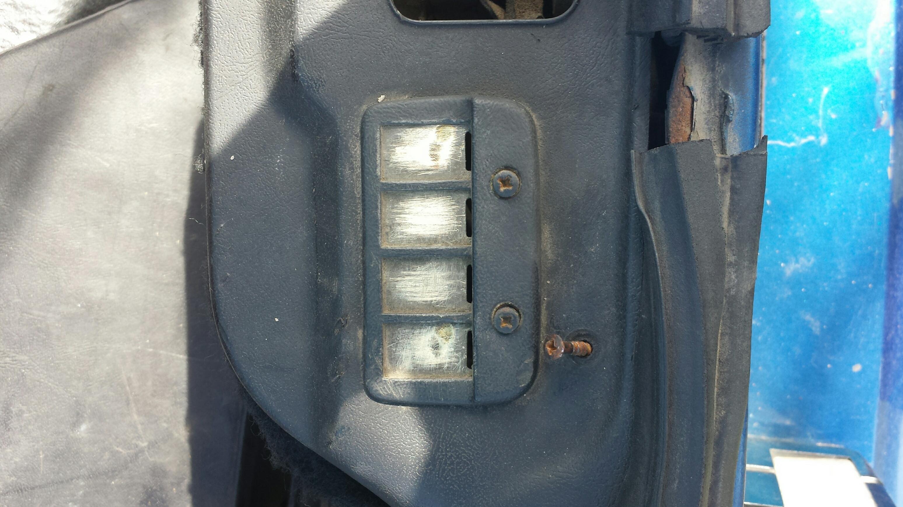

I don't get power to this switch at all.

I don't know the procedure for checking that switch but I tested mine with a test light and I'm not getting no power there either even with the brake peddle down,but I still have brake lights.So I would advice you to pull down or put a piece of cardboard behind the switch on the Hatch itself.

The superfluous brake light (clown light)
uses the same fuse as the normal brake lights use however it uses a separate contact on the brake light switch.
Using a fused jumper, jump the
yellow wire to the orange wire at the switch.
If the clown light comes on your problem is a defective switch.
If the clown light still does come on make sure there are no breaks in the run of the
yellow wire.
