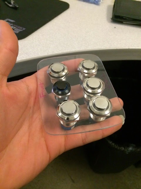

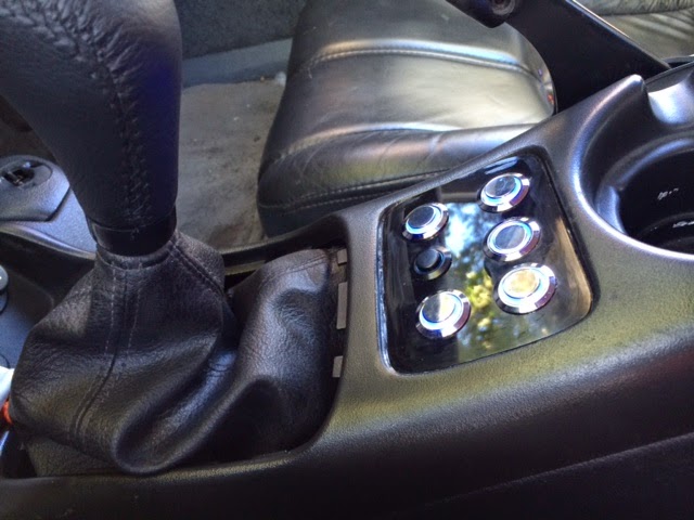

Hey Everyone,
Last time i was on this page i was when i was 19 or 20 yrs old, which was when i first had my first 1992 Camaro RS 25th Edt TBI 305 5speed. unfortunately that car was junked due to major damage to the motor, at that time i was not able to fix the problem and had to let it go.
On a brighter note just recently i decided to hunt down my original first car, it was a long search but i managed to stay positive and located an Exact Match!! It was Completely Stock NO Alterations to Anything Like a Dream come true!! LOL Had to Drive 7hr down to SoCal for it. Well worth the gas and time!!
So that's a little brief history on my car and how i became a Third Gen Owner. Now the project on hand is as follows.
I took out the original center console out and installed one from a 98 camaro ( just like everyone has done). I'm planning on taking out the original power window switches and installing Momentary On/Off Push Buttons Switch (picture shown below). Has there been anyone that has done something like this? It would be great to see how anyone has gone about in doing this switch mod. If not i will be trying to do my best in keeping this thread updated every week and giving details on doing this mod.
Knowing that this are on/off push buttons i assume i will be needing 2per each original switch.

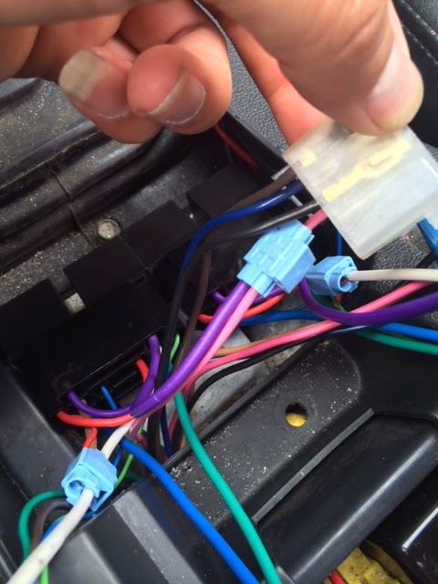

And yes you guys are correct i was doing some research and found the schismatic for the window system the total amps that are being pulled are 35A, and yes i might just run some relays. In regards to the wiring ill see what i can do to keep it as clean as possible
I will find a way to get this switches in my car!! lol No worries electrical is no problem.
The benefits of working in an Electrical Contract Manufacturing Company, is that i have a couple of electrical engineers that wont mind helping with a little side project.
Back to the schismatics.
I recently bought the Camaro Haynes Repair Manual when i was replacing the clutch just 2 weeks ago, and found a MUCH better schismatics in there.
here is a picture for you guys who don't have them.
my next step is to figured out the wiring and put it on paper for better understanding.
will update on Monday.

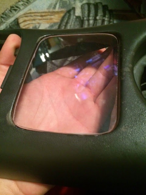

I have a question for you guys with the (4th gen) center counsel.
Have you closed up the ash tray in the center, and what type of marital did you use?
-carbon?
-sheet Metal?
-Plastic?
-fiber glass?
I want to use something but don't know what would work best?
I had it closed up with thick 1/8 plastic glued in place with epoxy and drilled holes for my original window switches.

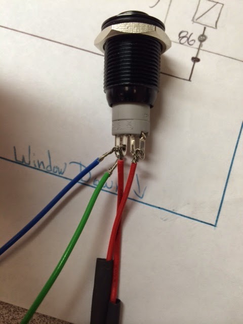

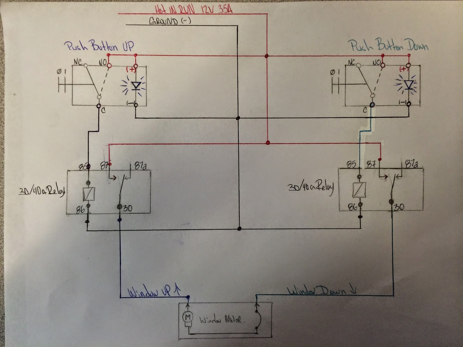

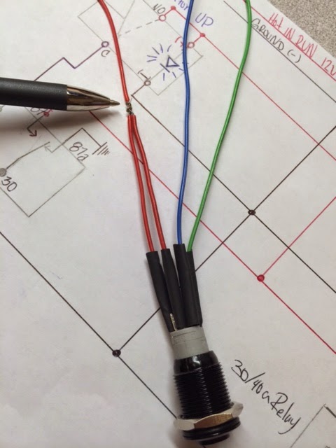

So we have got some schismatics on how i'm going to wire each switch.
wiring is as follows:
One Window schismatics
UP-Push Button & Relay
(+) = 12v
(-) = Ground
NO = 12v
NC = leave alone
C = Relay 85
87 = 12v
30 = DK BLU wire
86 = Ground
87a = Ground
Down- Push Button & Relay
(+) = 12v
(-) = Ground
NO = 12v
NC = leave alone
C = Relay 85
87 = 12v
30 = Brown wire
86 = Ground
87a = Ground
This way the LED in the button will always be lit when the car is running.
eseibel67:
I just realized that if (+) and (-) get wired to the instrument light you will be able to dim the LED's and control the on/off buy the *** that would be way better!!

I like your written description better than the picture. It will work. You have a diode symbol for the lights in the switch. And just to make the whole thing make more sense, show the ground connection at 87a at both relays.
And yes, in this scematic the switch lights will always be on with ignition. Would be better to rig them to the interior lights.

Your schematic is 95% right. As mentioned above, pin 87a on each relay needs to be connected to ground. I also agree that the switch LEDs should be wired to the interior lights instead of switched from the ignition. If you change the wiring of the LEDs, then I would suggest wiring the switches off of a power wire that is always on. That way when you forget to put the windows up and it starts raining, you don't need to find your keys before running out to close the windows.

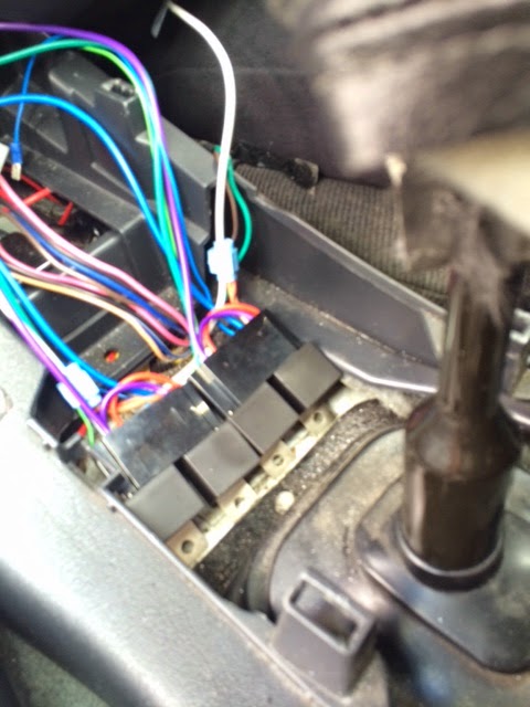

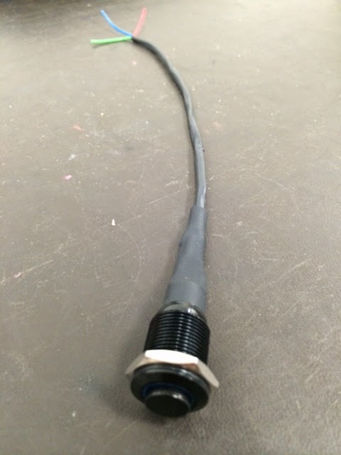

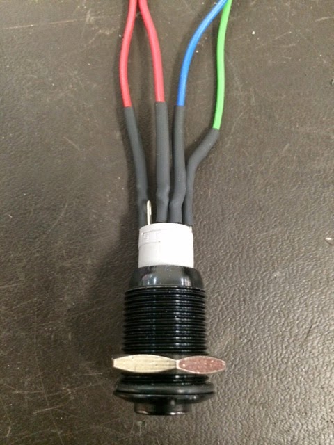

sup guys,
This past Friday i received some part in the mail.
Got the Relays and dual connectors pre-wired will post more pictures of that tomorrow. i also got my trunk latch Switch which is Black!
I did manage to work on this switch and here are a couple of pictures on how i did the wiring.
Notice how this switch has a High Head Push Button i chose to go with This Style which would be better to push down, instead of the Low Head (flush) Push Button.
My Switches that i will be using for the windows wont get here till 5/12/14 coming in from China $4.95/each super cheap compared to $10.00-12.99/each from stores here in the US so for now ill be working on getting the relays and mounting holes ready for the switches.

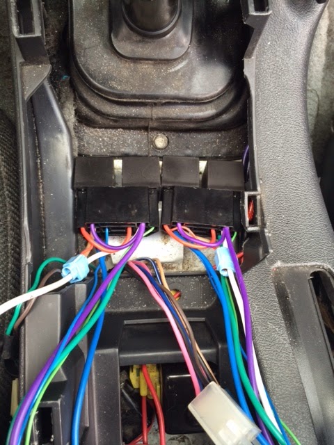

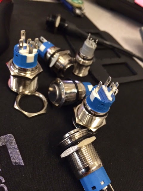

Sup ppl!
I have been working on this on and off and trust me, I'm tired of not being able to lower my windows and want to get this project done!!
on the good news side. i have received my push button switches earlier then expected!!!!
As you may tell by looking at the pictures i have side connected the wires instead of cutting them clean off the original connector. that way if you ever want to go back to your original window switches you can simply disconnect all the wires and remove all the relays. 1. 2. 3. your back to stock window switches.
also i have some more pictures
enjoy.

Oooohh. I'm not too crazy about those scotch locks. If your Big Gulp splashes some Mountain Dew down there the connections will corrode.
I'm a big fan however of solder & heat shrink tubing connections. It's equal to an uncut wire.

I agree those scotchlok connectors are asking for trouble. Especially on the heavier power wires to the motors.

FINALLY i got my connector in, the guy i bought them from was lagging it, in sending them .

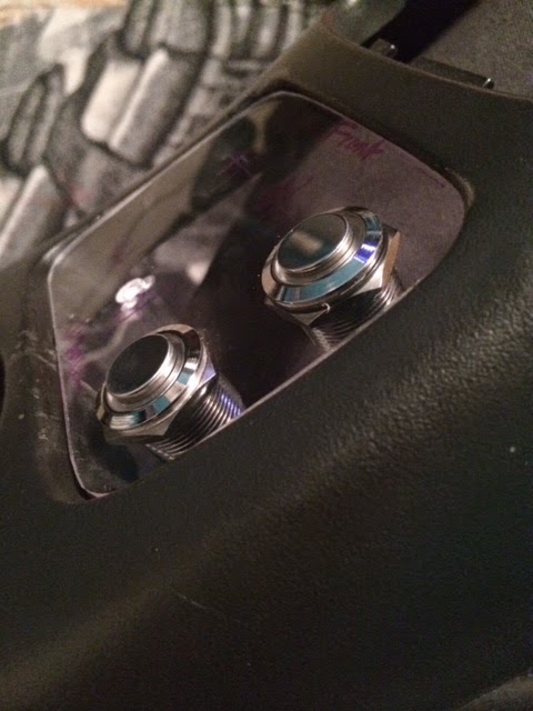

i wen to the store and picked me up a nice 10x6 (only $3.49) plastic and made the cut out for my template that will cover the ash tray on my center console.
I made sure i got it super flush that way the lines match up supper nice and clean!!!!!!
note: this is just a mock-up not the finished look.
after i got the nice cut out done i sanded down the edges and made sure there was some grip on the bottom side and a little on the edges. this is beacuse i want the epoxy that i will be putting on to stick it on good and hard will grab on to the plastic and STICK!!!!!! i did this to the edges of the console as well.
i then started to drill the holes and did my best to set them even from each other. im not going to lie, it took me a while to finally decided that's the location i wanted to drill. lol
moving on,
i pre-installed everything in its place where it will go just to get a look and feel of how it will be finished and if it needed to me changed.
well so far im on track and i hope to finished this project by end of Saturday.
eseibel67: you are RIGHT!!!! i didn't think of that. i have some shrink tubing that i will end up installing just to cover all the cut wires and connections.

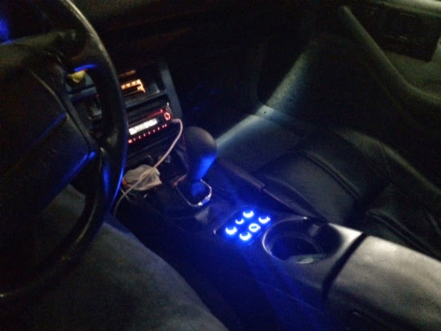

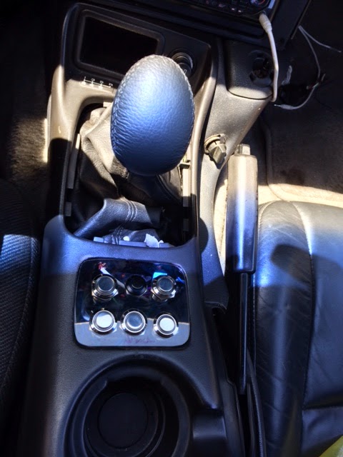

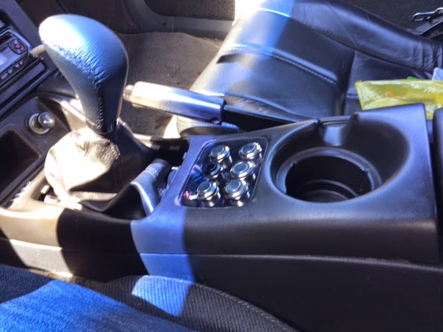

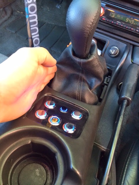

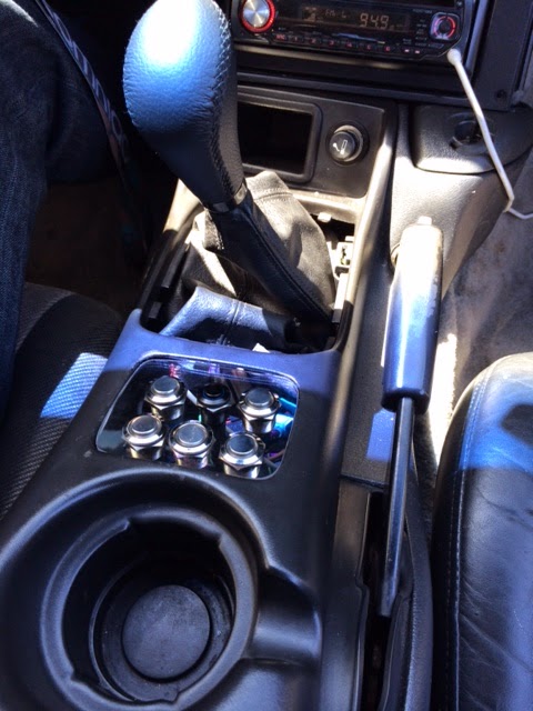

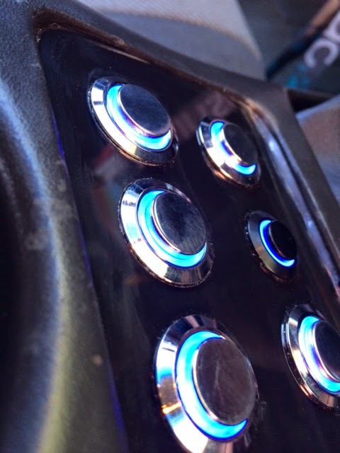

Its Monday at last!!!
hey everyone,
i have completed my project of installing new window switches \
well not exactly completed 100% i need to measure how much current the LED's are pulling so i can solder a lead resistor. which will help me control the Dimming by the same pull switch that my instruments use!!!!! all controlled by one main switch!!
i did also paint the bottom part of the plastic that the buttons are mounted on, by leaving the top unpainted it will look like a clear cote is on it and it just looks sweet!! lol
As u may notice by the pictures i have extra 2 center buttons
the black one is for my trunk latch and the center chrome one is for my ON/OFF AMP.
Right 2 chrome buttons>> driver side window UP/Down
Left 2 Chrome buttons>>passenger side window UP/Down
