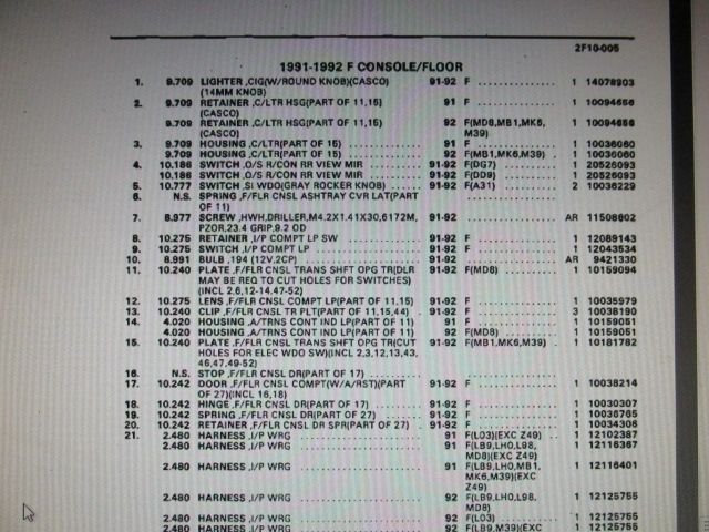

Does anyone have the GM part number for a replacement cigarette lighter socket for a 1991 GTA? I've searched high and low, but all I can find is the actual cigarette lighter itself.

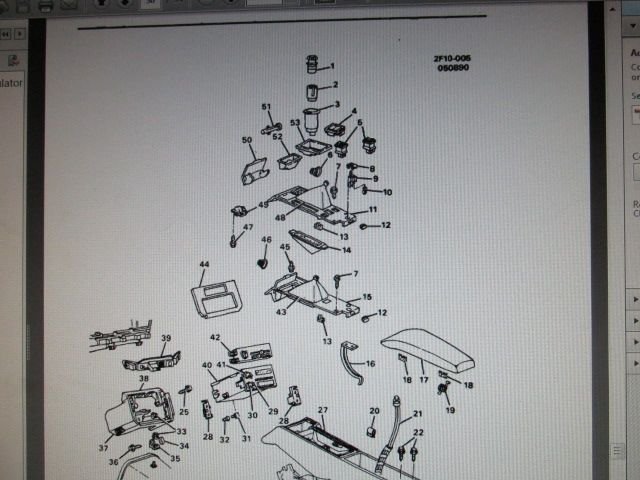

Here's your P/Ns
