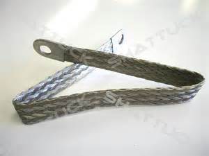

u can use a meter to test for good ground spot. but engine to something is fine
typical ground strap looks like
