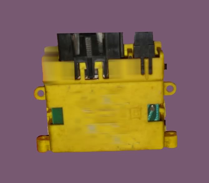

Your problem is consistent with a bad connection.
You can ‘ohm them out’ to make sure you’re getting good contact.
Pay particular attention to the VSS and buffer connections.
The Buffer is located behind the instrument panel at the right.
