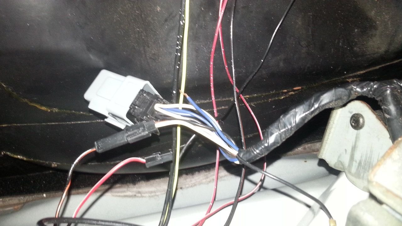

This is a picture of the wiring at the latch. Note the unattached blue wire and the red/white power wire with the female plug on the end. Are these to supposed to connect?
