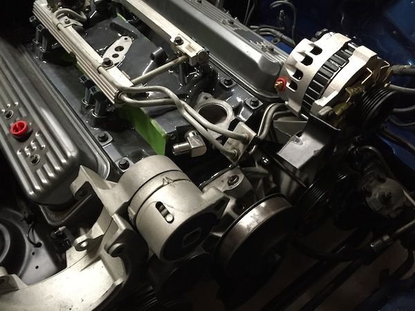

Ordered a 200 amp alternator and upgraded the wiring. The output post is too close to the valve cover. Should i expect to take to old alternator apart and swap the vertical bolt on style output?

See this thread: side post alternator.
If you don't want to buy a 140amp Powermaster alternator, you could disassemble yours and see it you can relocate the output post to the side of the case in the same fashion.

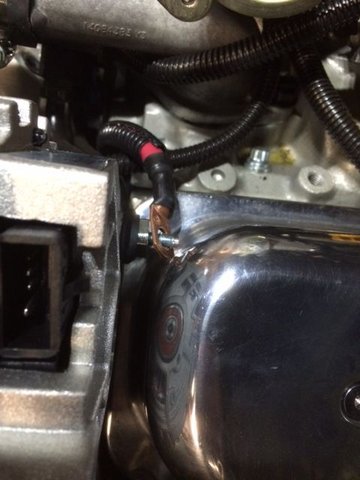

I ground some off the original peg then swapped over to the original peg with the bolt. I wish there was more but i could not remove the outer coil.

Looks like its just the post that's close to the cover.
I would put it together using the thinnest nut I could find then gently use a fine tooth hack saw/dermal/whatever and cut off the rest of the post on the other side.
Then use a rubber boot over the hole connection.
You always put the nut on a bolt before you cut them any way so on removal the nut straitens out the threads.
