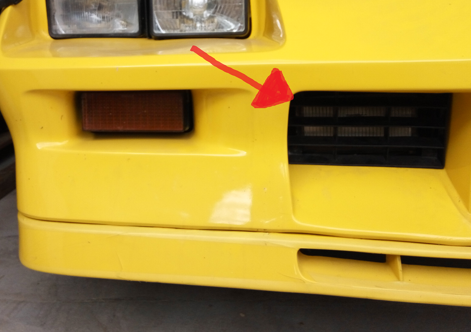

Can someone tell me how to hange the bulb light in this bottom front light ?
(see picture attached with red arrow)
From front , i can remove black plastic grid with 4 screws, then there are on the two vertical sides of glass some metalic parts but is i open them, i can't remove glass.
From behind layed under the car, i cant remove bulb also ...
Thanks for your help

It's not OEM Fog lights, it's a French car , and it's the "position lights" .
The ones that you switch on when it's just a little dark.
i can't remove it from behind like your youtube video....

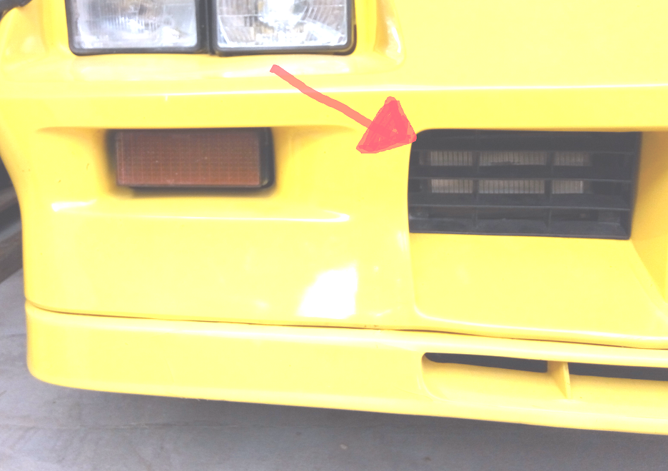

I brightened up the photo a bit so we can see the light you're referring to.
I'm thinking you can get to the bulb either from the top (in front of the radiator support) or from underneath. Either way, you're going to have to remove some of the plastic panels. I'm sorry I'm not much help.
Is that light a factory installed light for export models only?

Took time to look at today ...
Remove the four screws of the black grid.
Then push the up of the light to have him looking a little to the sky.
There is a bottom screw... in the middle.
