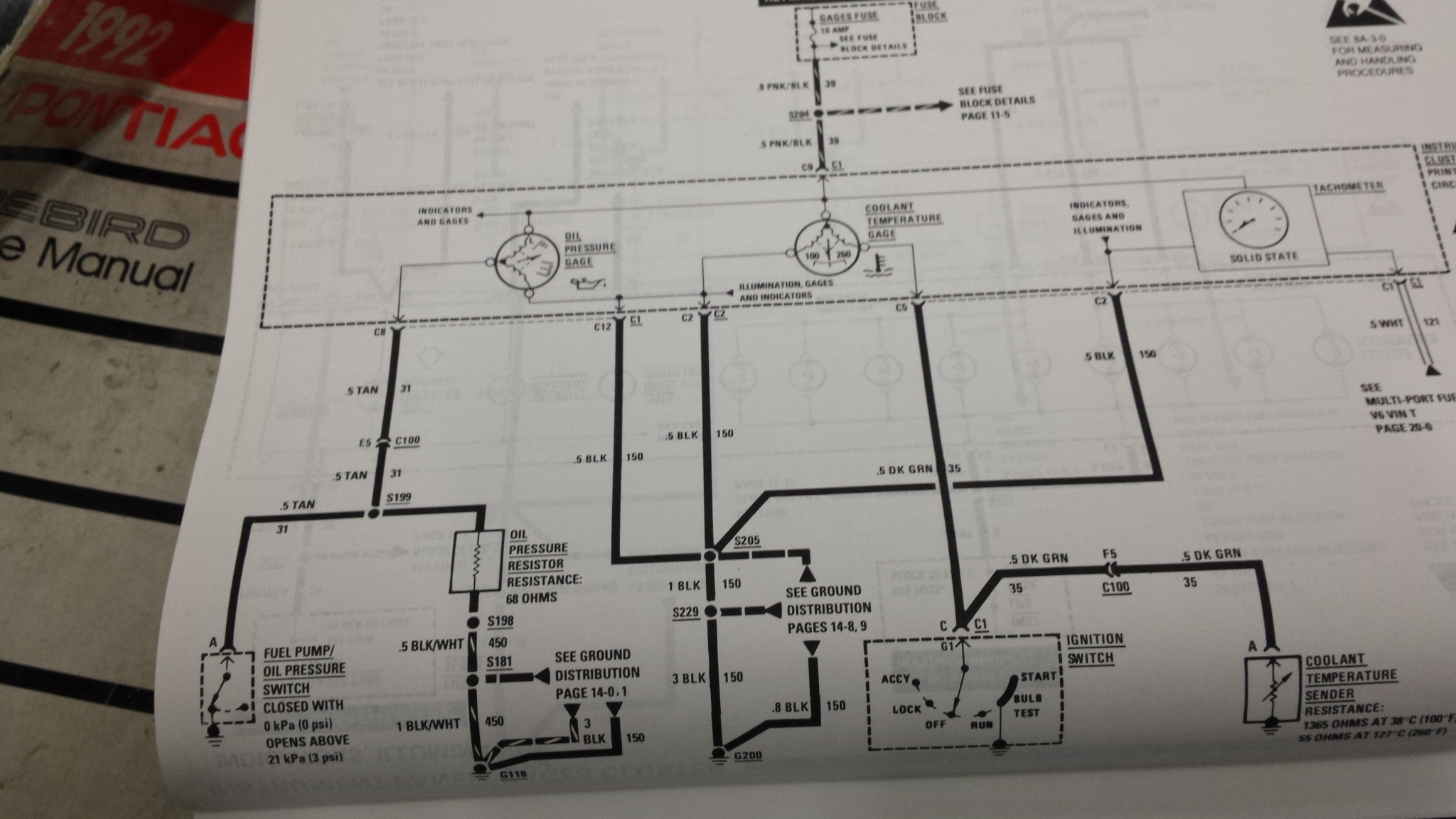

After that I went into electronics, here is the simple wiring scheme:
I checked the voltage at terminal D, orange wire -> ok
I disconnected my fuel pump relay. After few seconds, engine starts, so it seems that the backup works after reading oil pressure.
I checked the grey wire to the FP relay -> ok
After that, I checked the TAN wire, terminal A to ground and to the instrument cluster. Everything seems to be fine here. I could even measure the mysterious 68 Ohms resistor. I spliced into the wiring harness and found the little fellow, everything seems fine, reads axactly 68 Ohms.
What is this resistor for?
After all this, I just couldn't find anything that is not as it should be. Im really out of knowledge here what the problem could be.

Not sure this is the problem. There are different oil sending units.
3.1 engine- standard #PS236.
5.0 & 5.7 engine- standard #PS228.
The PS228 Has 90 OMMS AT MAXIMUM PRESSURE. 0 OHMS AT 0 PRESSURE.
My 1990 Camaro with the PS228 has no 68 OHM resistor in the circuit. Works fine. If it had that 68 OHMS it would read high all the time I think.
I don't know the specs on the PS236 just that its different.
Some thing to look at.
Good Luck.
Good Luck.
