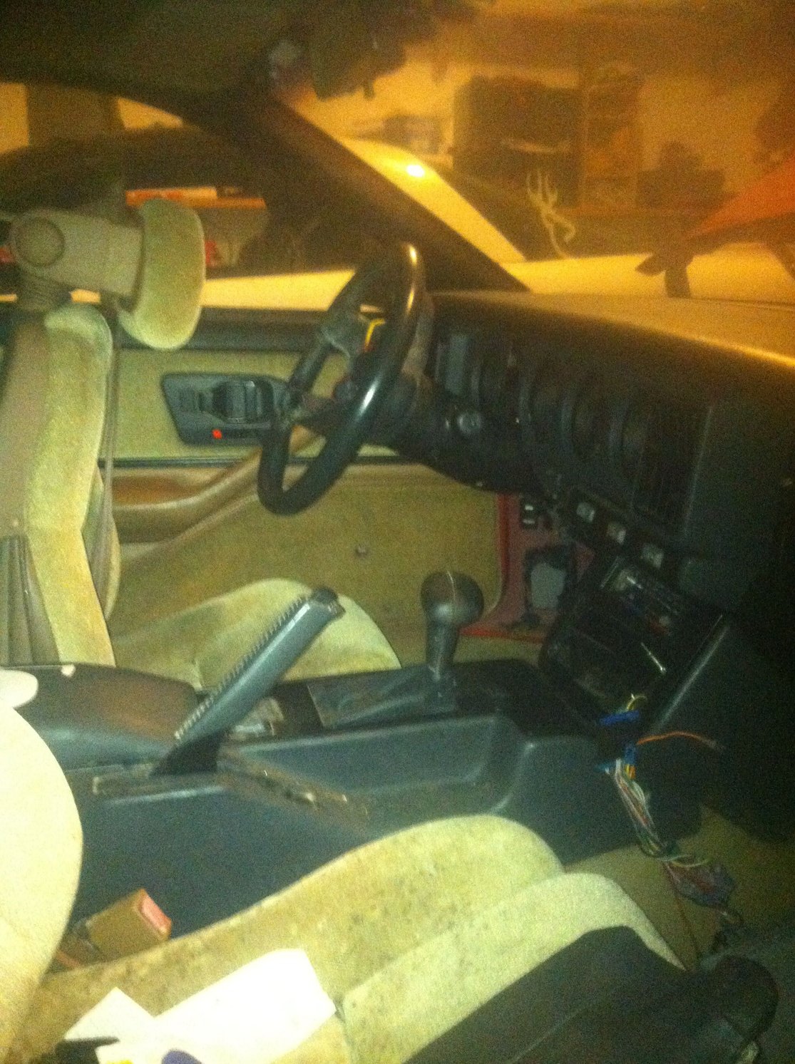

I picked up this GTA last week for $700. It has 126k miles, the wrong nose, mold, and a significant wiring problem. I've done a tpi and 2 lt1 swaps into my 91 RS so I figured Id help save this repo'd GTA. There are a few connectors I have not seen before and I'm having trouble getting info on them also under the drivers dash is a mess. If anyone recognizes electrical the items in the pics I post please help me out. I'll add a few overall pics of the car so you guys can see it. It's really not too bad...

Also from what I can tell, the previous owner tried to install a remote start/ security system

The headlight control module is gone, that's the two connectors and mounting bracket on the firewall.
All the relays and the module hanging under the dash are probably related to the alarm/keyless entry.
The green switch with the metal bracket is the hi beam switch, it normally is on the column by the ignition switch.
I'd start by ripping out the alarm. Everything with a wire nut should be inspected and repaired properly.
The bundle of wires under the driver's side kick panel area probably used to go to the start enable relay. That's part of the VATS system, the relay would have been in that square hole under the tar-like goop the factory used. Your hand is in the way in the best pic that would show the relay, but it looks like it's missing. The relays are most likely there to drive the keyless entry, the power lock relay is on the driver's kick panel above the start enable relay.
Once the alarm is out, you can start putting things back to stock.
