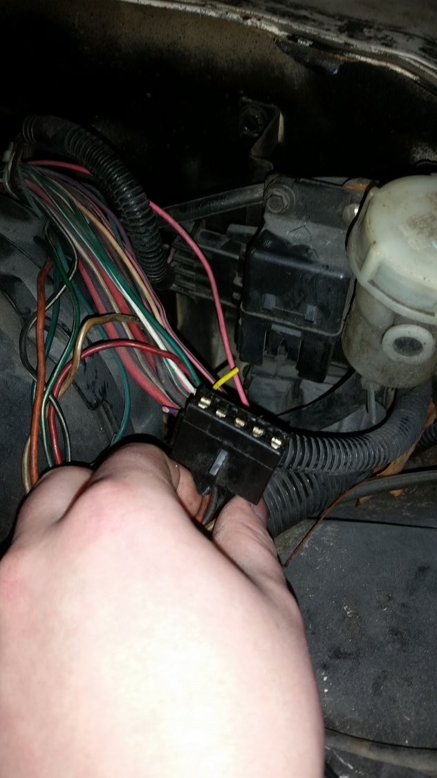

this is what i was jumping

okay that definately is the fuel pump because if i put power to the 'pin' on the far right of the picture i can get fuel. for some reason the hot lead on that connector isnt working

There is a fuse mounted on the fender near the charcoal can , it don't look like a fuse but it is , and that's the fuse you blew when you were jumping the wires . Always remember , a relay will usually have a + and a - for the coil , as well as a + and a fourth connection leading to the device the relay is controlling . When you were jumping connections you likely touched the + to the - and that's why the fender mounted fuse blew .
