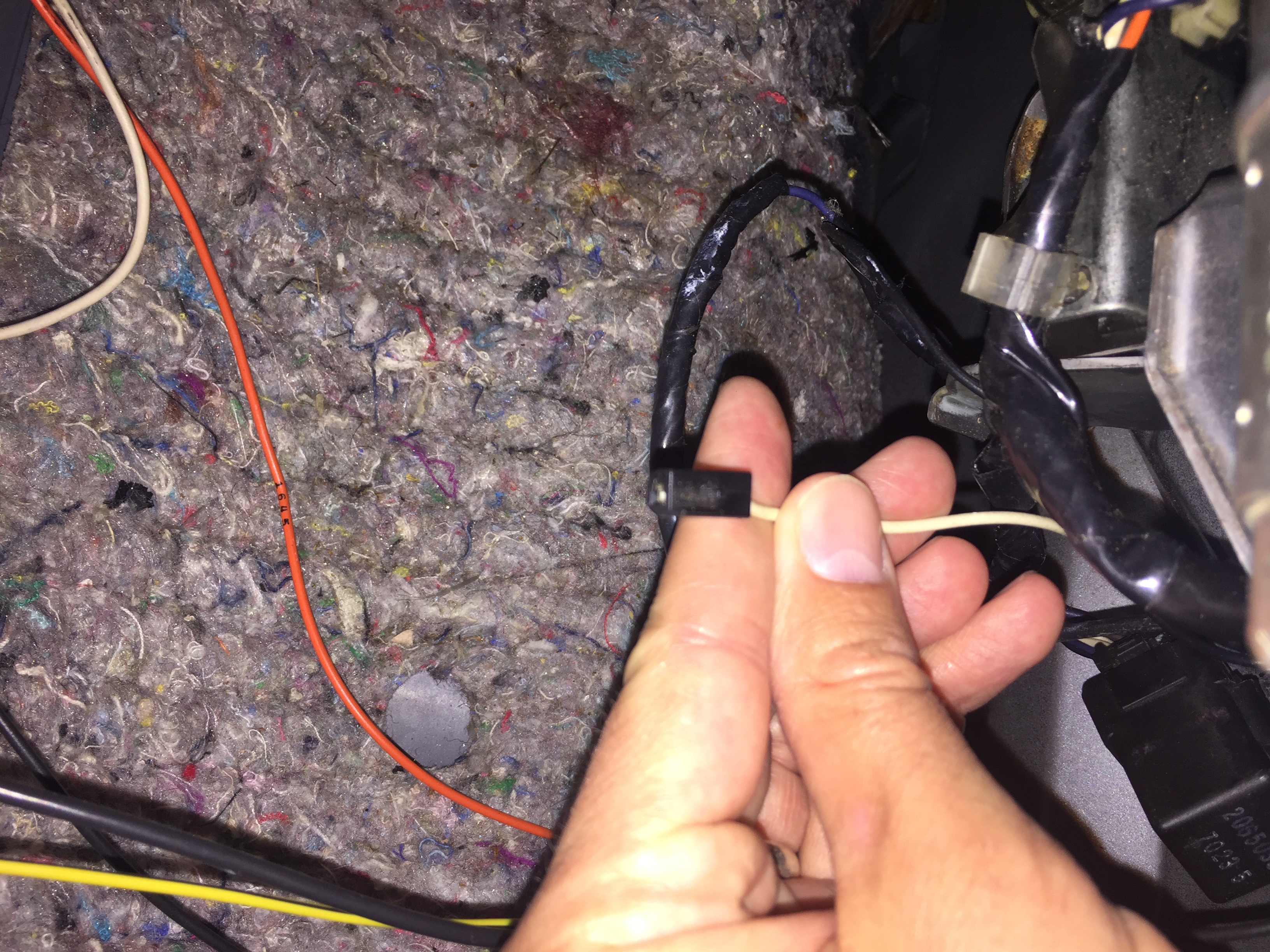

I just noticed this little white wire that doesn't seem to have anywhere to plug into. Where is this supposed to go?
Old Apr 11, 2017 | 09:43 PM
someone972's Avatar
Joined: Aug 2014
Posts: 575
From: Fort Collins, CO
Car: 1991 Firebird Formula
Engine: 5.7L TPI
Re: Latch pull down motor hot to the touch
Likely goes to the cargo light that turns on when the hatch is open, if you have one.
Also that white wire is for the cargo light but is not used on your model of car. You can try wiggling things around if the motor is getting power to try and unjam it. Always possible that something else is electrically wrong as well.
I actually found an old post from back in 2008 that basically said he same thing. So no worries there. Thanks for your help on the motor. Hopefully something works tomorrow. At least it's shutting flush now without slamming, even if the motor doesn't work.

The reason why the motor is hot to the touch is that it is still live and has not shut off because the pull-down unit had not completed the down cycle. You need to loosen the three 13mm screws that attach the frame of the pull-down unit to the body, then raise the pull-down unit a bit and tighten the screws. You MUST hear a CLICK when the pull-down unit completes the down cycle. That sound is the reversing switch being tripped to shut off power to the motor. In your case since the pull-down unit hasn't completed the down cycle it will not come up until you press and hold down the striker-sensing switch to power the pull-down briefly until the motor completes the down cycle CLICK. If the motor hasn't fried when you release the striker sensing switch after you've heard the CLICK, the unit will power all the way back up and again CLICK when it reaches the end of the up cycle.
The white wire with a small black connector on the end was used from late 89-early 91 to turn on/off the optional cargo light. It plugged into a black/orange stripe wire. It is a switched ground and provides the ground to the light. Earlier models used a manual switch to turn on/off the cargo light.
