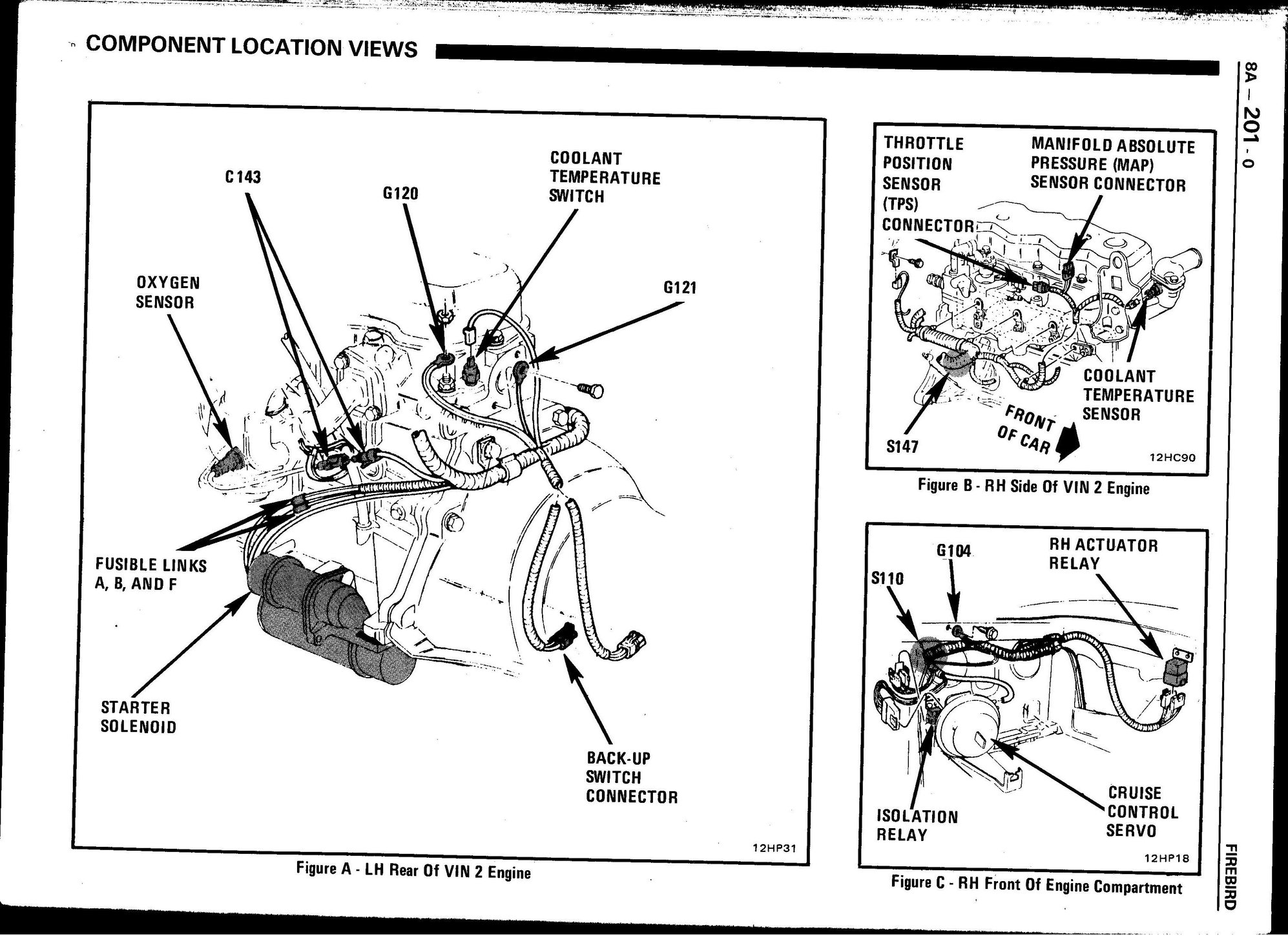

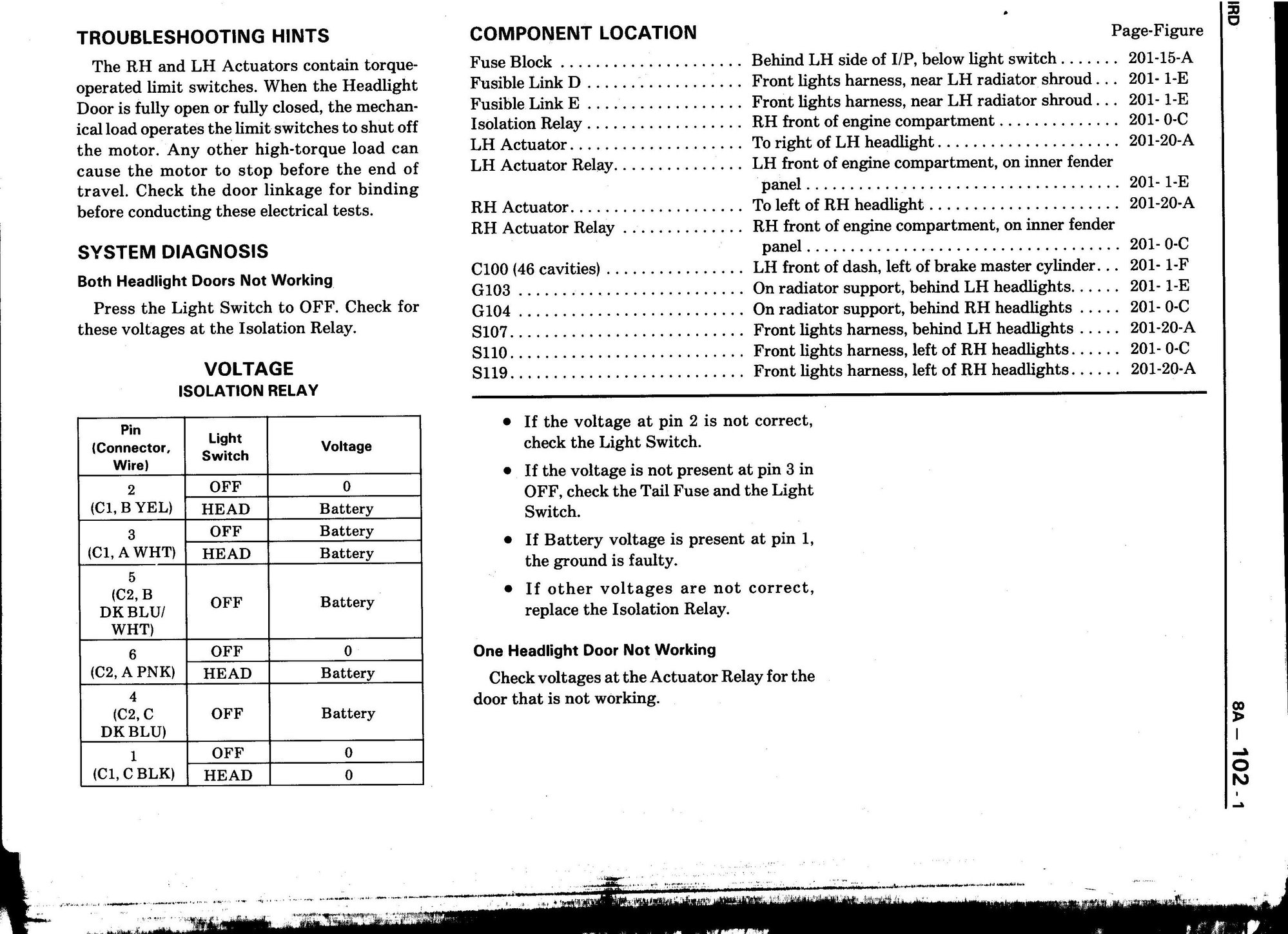

Re: 86 trans am headlight problem
Troubleshooting Headlight Doors for the 86 Firebird
Location for the Isolation Relay on a 86 Firebird
