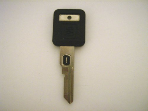

When you buy a VATS lock cylinder, it comes with a generic key blank with the teeth cut to match the lock, but no VATS resistor. You then take the non VATS key blank that came with the lock, and a new uncut VATS key blank with the right resistor value, and you copy the teeth from the lock cylinder key to the VATS key blank.
Make sense now?

The nice wore out key on the key ring is my original key. The basic brass key is what comes with a new VATS lock cylinder. So then I'd get a VATS key blank with a resistor pellet that matches my OLD key, and have it cut to match the key that came with the lock cylinder.
New VATS key blank.

Re: 89 camaro keys (ignition issue).
Originally Posted by mrpalafox
i tried that aswell but i get no reading either
Maybe your not on the right ohm scaling setting.
Yes i am at what is it 20 k but i took the key to various locksmiths and a gm dealer and there is no reading on the key
Looks like your down to trying resistors at the bottom of the column. White wires with a orange sheath. Or have your computers memcal reprogrammed to illinate vats.
https://m.ebay.com/itm/GM-VATS-Bypas...sAAOSwJLJZf7OT
Or if your car is tpi this might work. The vats signal to the ecm is a blue wire at pin f10. Or b6 for Tbi.
https://m.ebay.com/itm/GM-VATS-or-PA...gAAOSw3fZZ6JWY
is 305 tbi but i dont know anyone who can reprogram im in long bech ca i tried the resistors also with no luck
Something about that Ebay description doesn't really add up. Just dug through a bunch of info on 4th gen VATS and the BCM a few months ago. Everything I read suggested the 4th gen VATS signal is different than the thirdgen signal. IDK, maybe the Ebay module produces two or more different tones, but from what I was reading a 4th gen BCM won't send the signal a thirdgen ECM would be looking for.
FWIW.
I can do a prom to illimaite vats for 89-92 only for $65 shipped.
If you remove the prom the car will start but run poorly.
Send me a pm if you need a prom . Just need to know if it’s a 305 or 350 swap auto or manual transmission.
FWIW.
They have duel frequency modules 30 and 50hz. I can’t recall what thirdgen are I think 50hz but not 100 percent sure.
http://www.bakerelectronix.com/products_vats/
No I use stock calibrations and disable vats.
You can use your same key but will need to bypass the starter enable relay. Bye grounding the passkey wire or connecting the two large gauge wires together. Usually green and yellow.
https://www.thirdgen.org/forums/elec...cm-delete.html
I can ship priority tomorrow morning or Saturday. It would then take 2-4 days to get to you. Send me a personal message if I can asssist.
