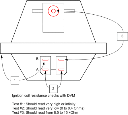

87 IROC Z28 TPI, stroked 330HO crate motor; stepped into it for 1/8 mile let off gas and it popped and was dead. Coil wire was burnt into close to the dist cap. Inspected cap and rotor then replaced the wire...only has 1/8 of the power. Should i check the coil and how to test the coil?

http://easyautodiagnostics.com/gm/4....ed-icm-tests-1
