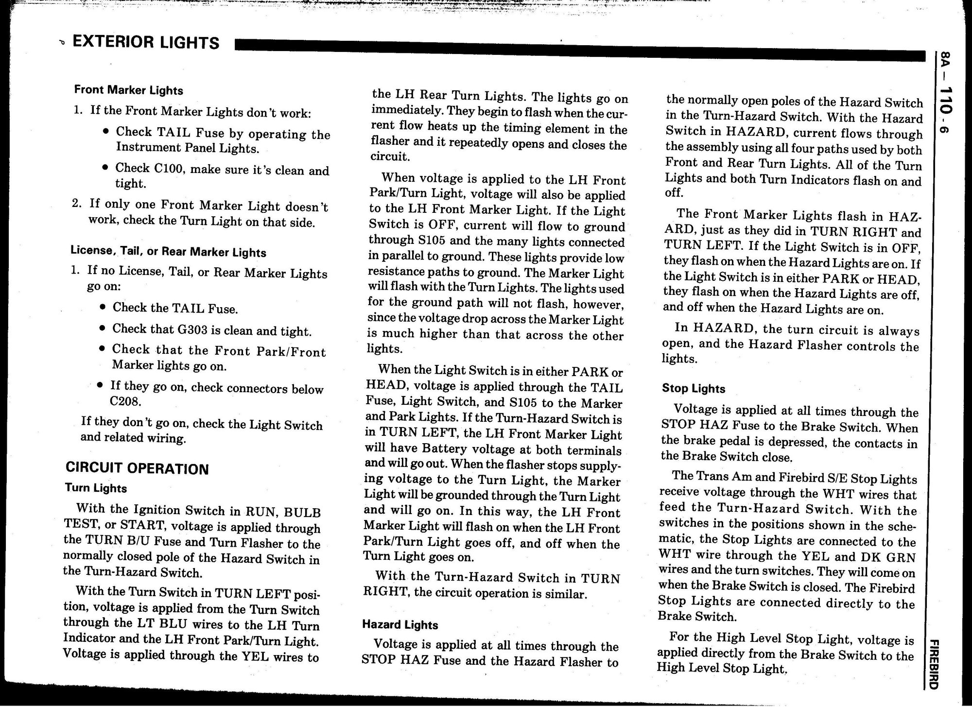

hello i have a problem with my 1989 firebird
when i turn the lights on the front marker lights are on (side and front), when i set the turn signals however they will light out of step (unsouncroniced) but when the lights are off everything works fine
can someone help me ?

No Problem,that's the way they operate

I was going to say, sounds normal for my car too
