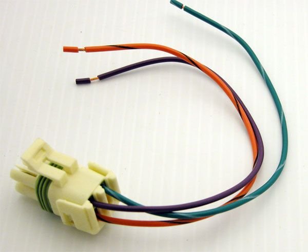

Maybe this will help.

Re: 700r4 lock up
Sorry, that dosn't show me anything, that's just the new plug in
