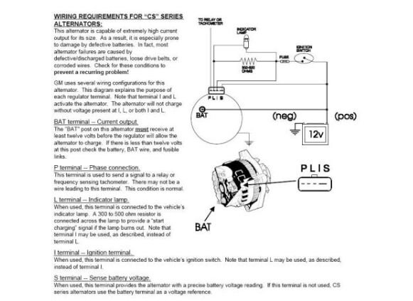

so using these two examples,what wires from the two pin plug from the right diagram would i connect(and to what of the plis pins) to the four pins,sorry im not too electronically oriented and looking at both it is mildly confusing.
Old Aug 24, 2018 | 06:45 PM
1986BANDIT's Avatar
Joined: Mar 2017
Posts: 902
Likes: 139
From: waterloo ontario
Car: 1986 trans am
Engine: 305/350
Transmission: 5 speed
Re: can i use a 1991 4 pin alternator in my 1986 trans am with a two pin connection ?
like #1 on the right diagram goes to what letter pin on the left diagram,same with #2.im probably under or over thinking it.

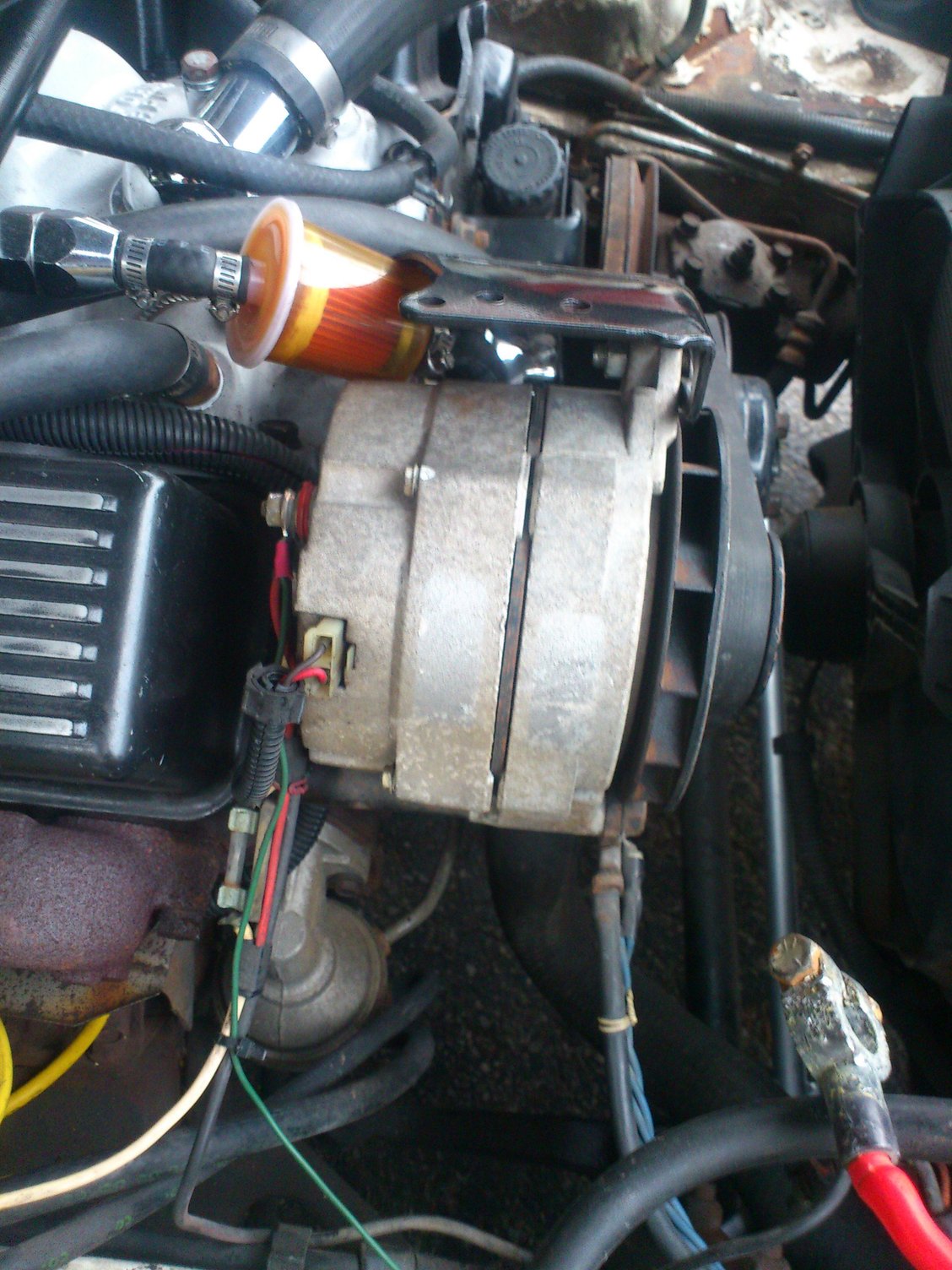

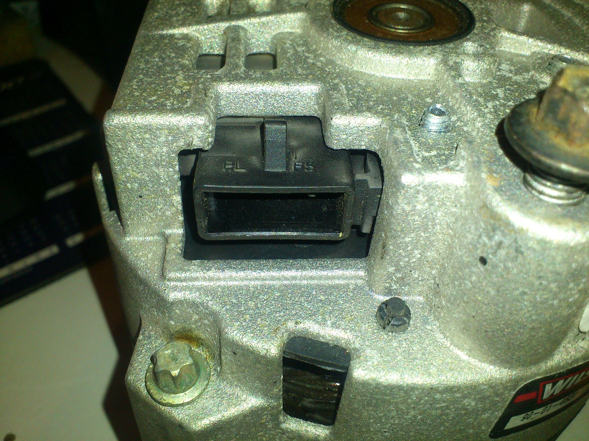

here are pics of my existing alternator and my new one
If you have a idiot light you need a resistor.
https://www.jegs.com/InstallationIns.../764-30707.pdf
terminal 2 from the si is bat power or hook to the large lug on the alternator.
terminal 1 is a ignition switch power.
i bought a pigtail ready to change it out,in the meantime i charged my battery for a day and a half.
i filed down the posts nice and clean as well as the terminals in the car,examined all the connections
and pulled the fuse for the amp(big *** wire that was there from a previous install)i hooked up the
battery and it fired right up.i just got back from a nice drive(in the rain F%$X...)and it started up fine so
that tells me the battery is good(also had it tested,results came back good)and the current alternator is
doing its job otherwise that 10-15 minute drive would've drained the battery fully.
so now i do have a plan if it happens again,thank you kindly for all your advice.
