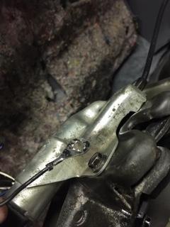

jprformula, I sure hope your DON'T have power at the black wire with a ring terminal on each end. There IS a black wire that has power ONLY when it is sent from the hatch release relay. That black wire plugs into the end of the hatch release solenoid. There is another short black wire that has a large ring terminal on one end and a smaller ring terminal on the other. That wire goes from the body ground location (below the hatch pull-down unit) to the 10mm screw that attaches the hatch release solenoid to the latch assy.

here is the wire in question, it looks like a ground to me but in has power. a little history on the car. bought it brand new, sold it in 1996, searched for it and found it in 2006.when I sold it, it was perfect, when I bought it back it was a POS. So Ive been restoring it for the past three years and i have taken many pics of the deconstruction and it looks like the wire in question was grounded to the hatch release motor as you will see in one of the pics, does this sound right or does it go somewhere else,or should it not have power?

Any thoughts on the black wire ? where does it go and is it supposed to be hot ?
