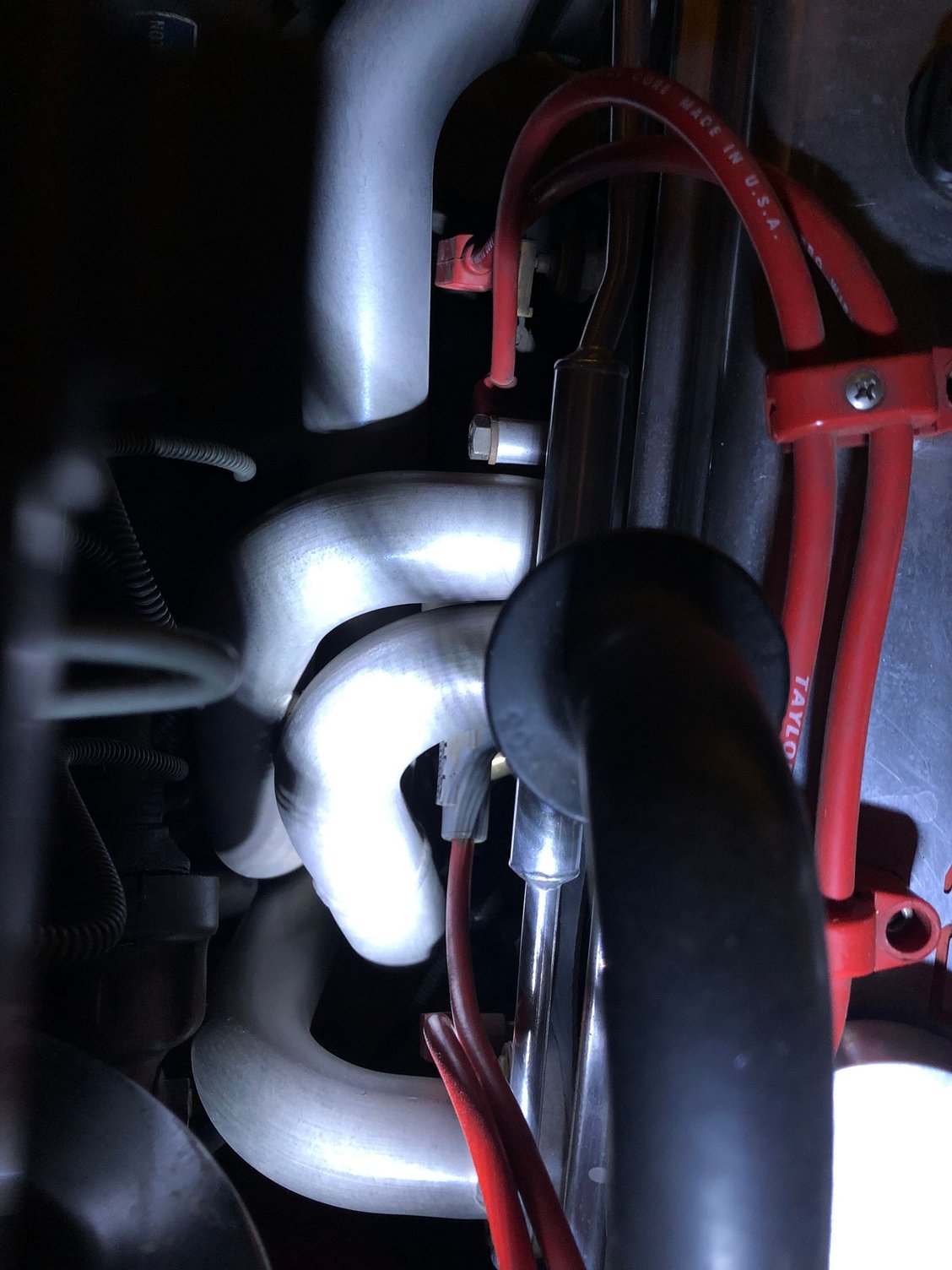

Just be aware that whatever plug you choose, you don't want it any longer than what you currently have because the plug boot will get burned by the header tubes.

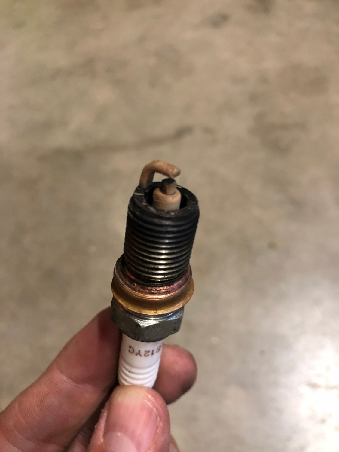

Did you notice the copper indexing washer? The headers look like they are SLP.
Okay, I was considering the Rapidfire but they are 1/4” longer than factory plug so I think I will look for another option. Yes I saw the copper washer, I honestly didn’t know what it was until I just looked it up. Do I just re use the washer on each plug?

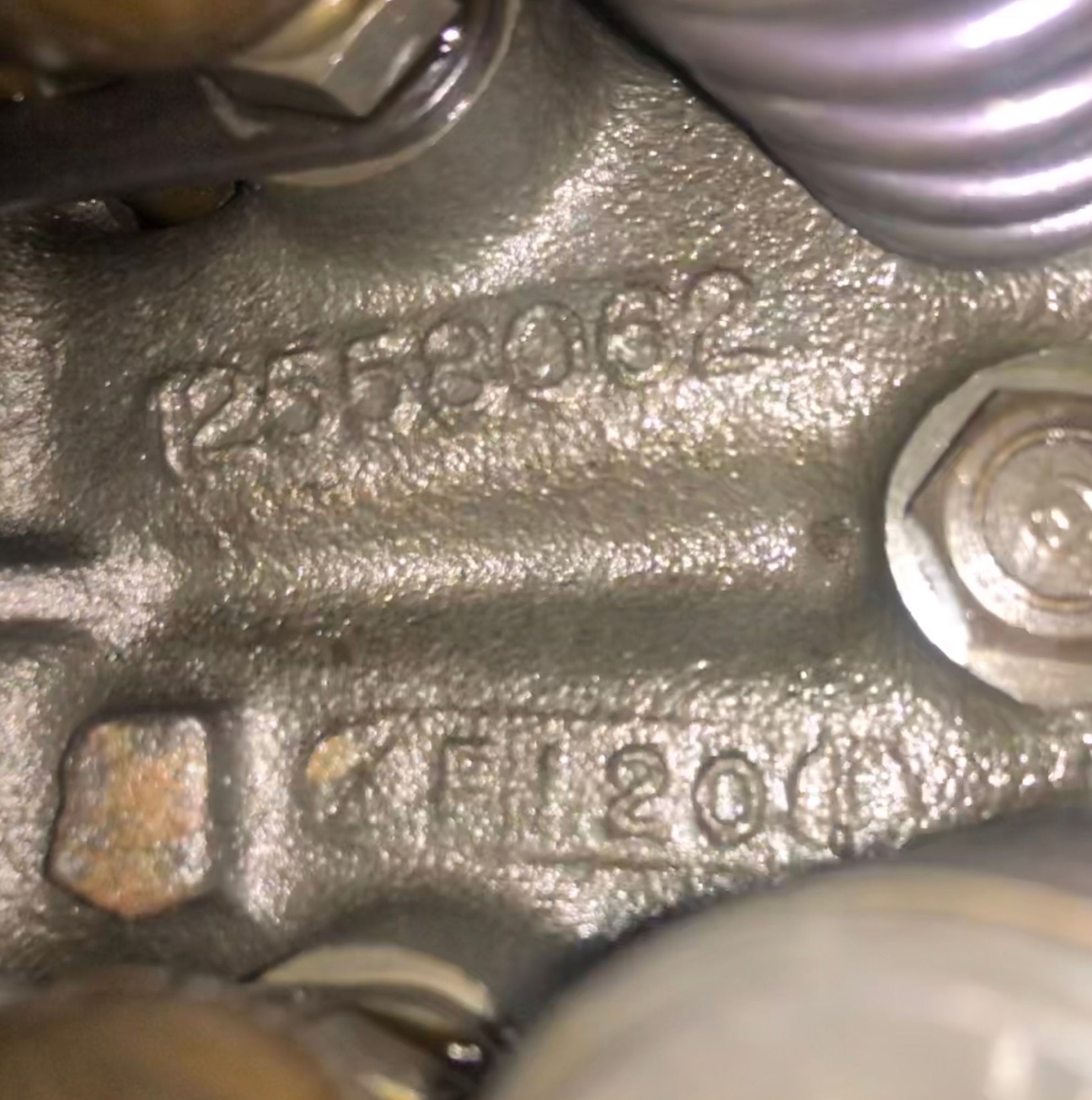

A magnet stuck to the heads so they are cast iron. I was able to take this picture by removing the oil fill cap. Does this help to identify at all or do I need to completely remove the valve cover?

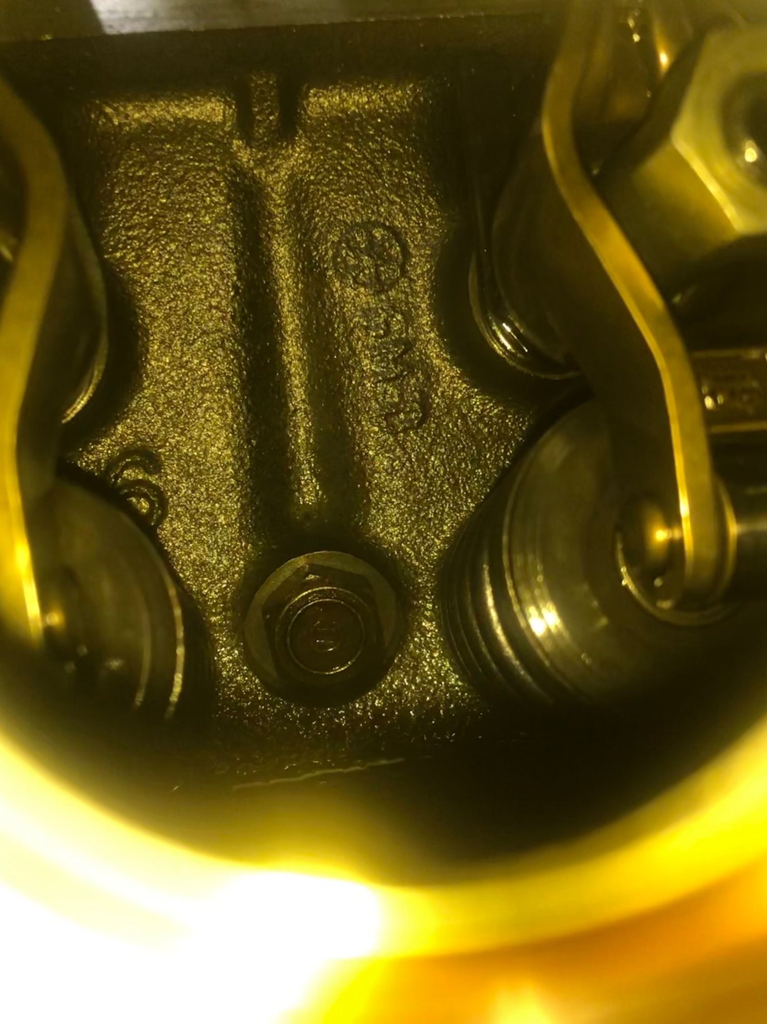

I was able to lift the valve cover up and get this pic. Looks like it corresponds to a iron Vortec head.

Yup. Iron Vortec head. One of the better ones. Bonus points for it being really clean.
Oh, and NO, you can't re-use the indexing washer. Every plug is threaded differently in relation to the ground strap.
Different thickness indexing washers allow you to position the strap so that it does not block the spark from the air/fuel mixture.

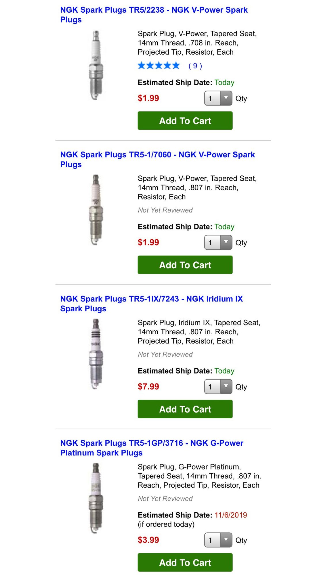

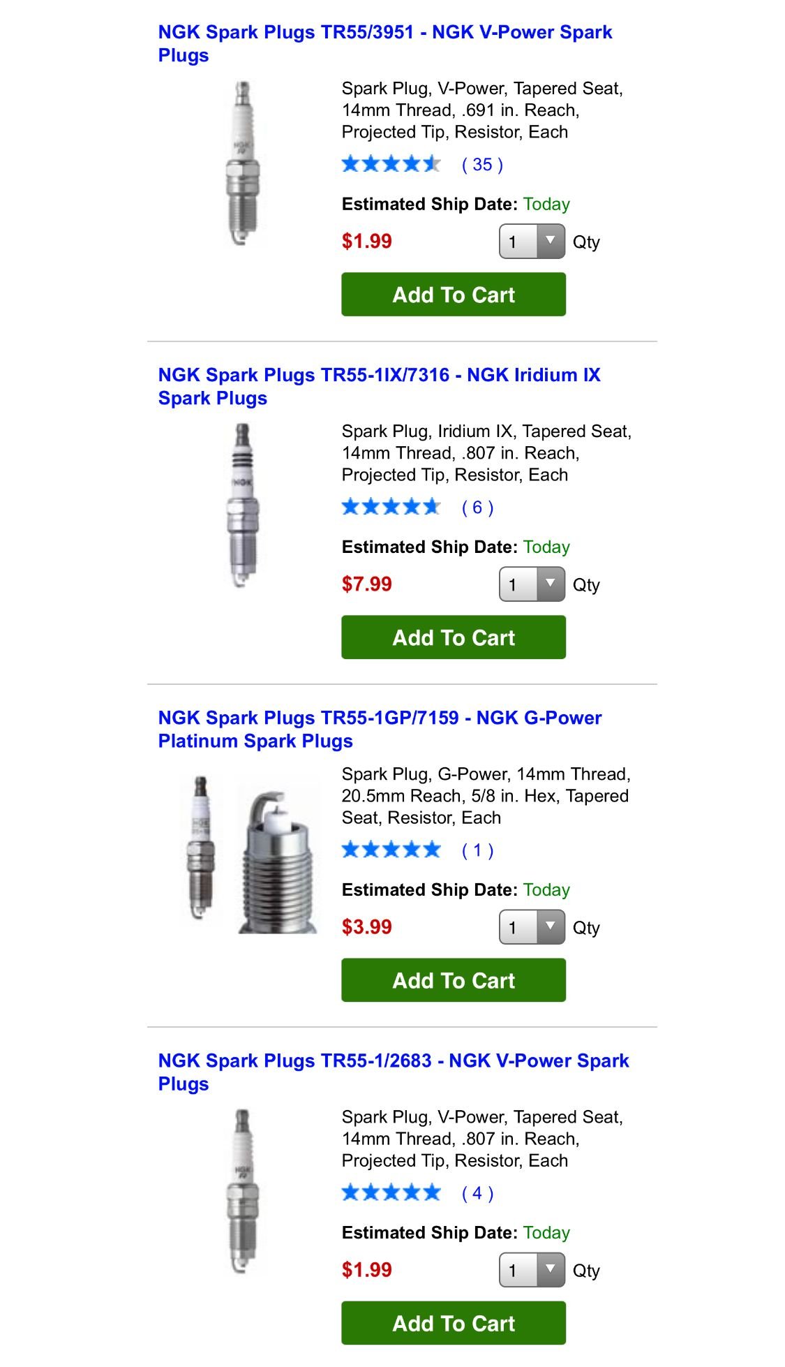

Here are the (4) choices for the tr5 and the (4) for tr55. The vehicle is equipped with a Jacobs Omni Magnum ignition. They all seem to be heat range 5. Is the only difference the material of the electrode tip and the reach? Which should I get? Also on a side note I am trying to identify which intake manifold it has, I can see “firing order” stamped on the manifold under the throttle body with the firing order sequence but that’s it. Thanks for all your help, I really appreciate the learning experience.
Ted

Tr55 part 3951 is what i would try in 5.5 heat lol inbetween heat good for mild performance higher compression.
tr5 part 2238 is what i would try in 5 heat
a 4 is typically stock rating
the rest of them are slightly different designs. Looks to be a typo on reach tho, ones saying.807 should be .708.
