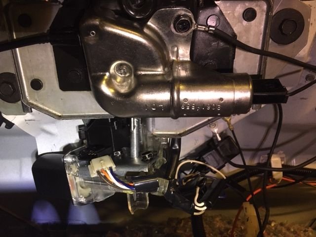

problem with the new motor of trunk
Hello, I am french, sorry for my ignorance
But I have changed the motor + housing and I have the system who down and up continualy without stop and closed the trunk........
I must to open the trunk at the dash buttom for stop the work of motor...
perhaps a bad adjust of run between the switch ....
When I take my finger, the motor down until the switch inverser work and the motor up, and continualy....
I clean this contact but not more

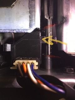

In the quoted picture you posted, the striker switch is on the top left part of the latch mechanism. In your picture it is what appears to be a brass type color, and has that "nub" protruding from the top of it. For lack of a better way of describing it.
With your rear hatch open and the motor plugged back in, you should be able to press and release this switch manually with your fingers to watch the hatch pull down do its thing to better determine the actual issue.

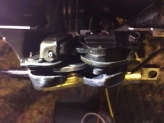

Okay, below is a picture of mine. It's not the best but if the positioning of the switch is your problem, then it should help guide you in the right direction.
I tried to get a better look at your very first picture, it almost seems like the switch is sitting above the top tab, but is difficult to say for certain.

but on mine the switch is sitting between the two tab, and it is why the strikker works goods, it 's go up and down, the reversing switch works
