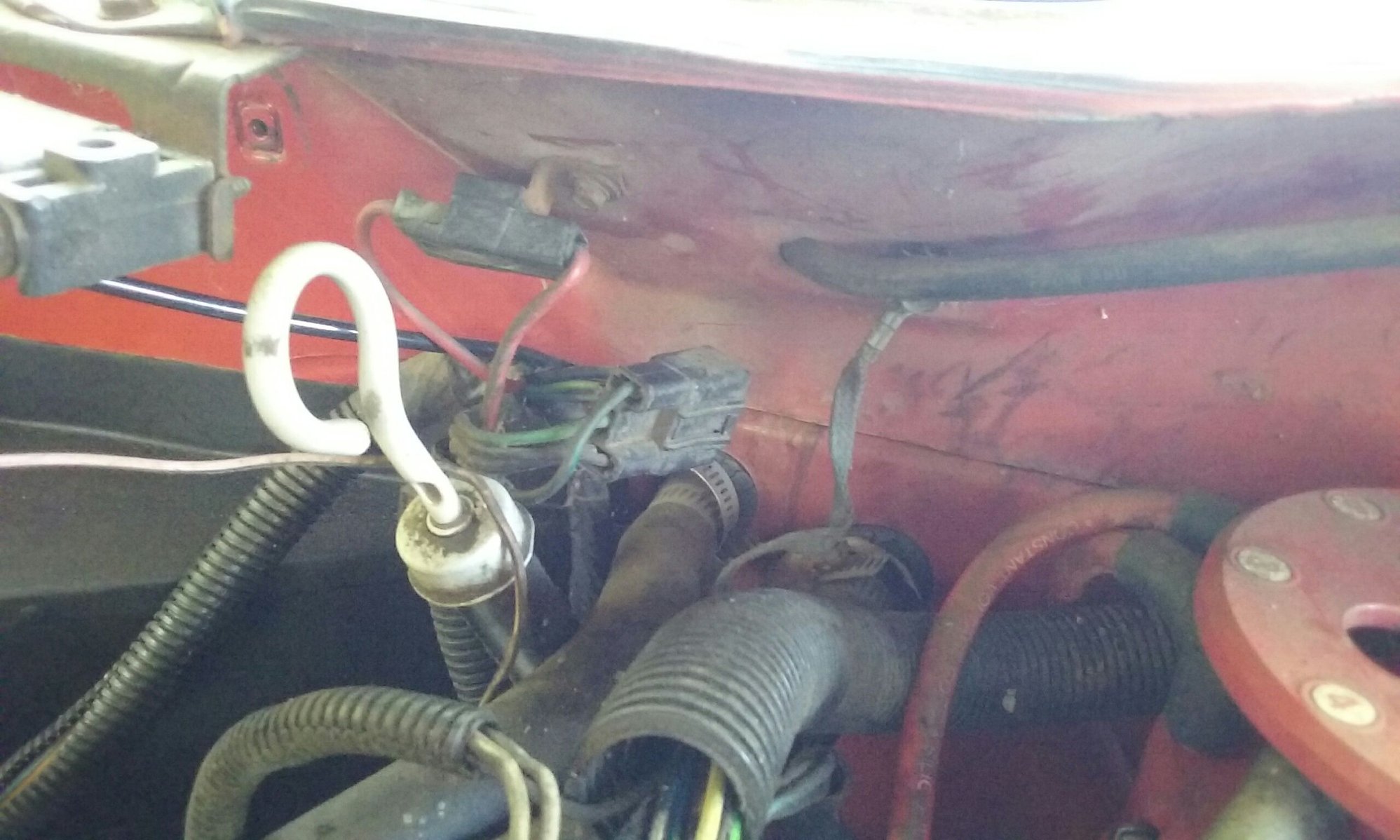

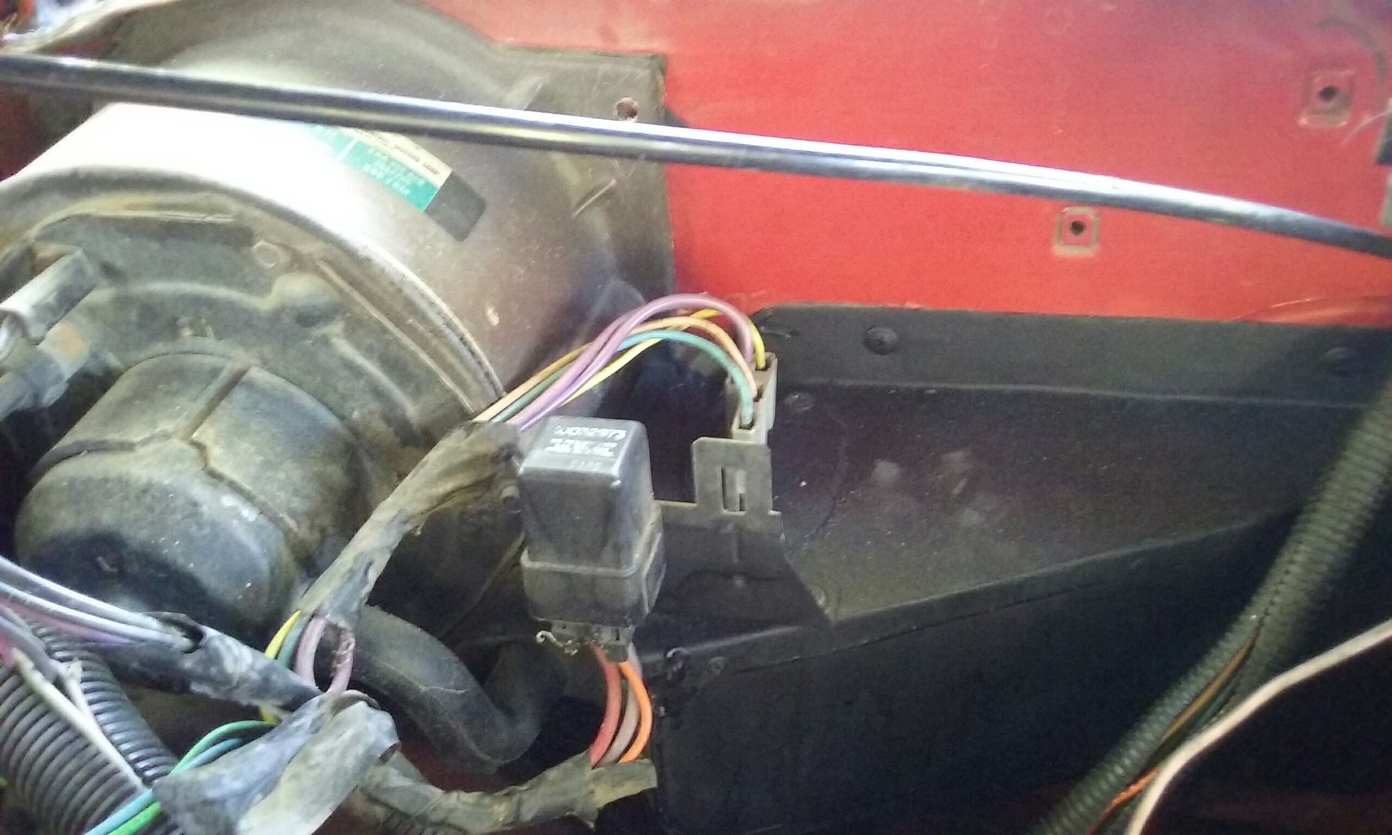

Started removing wires starting with connectors that have been disconnected since I swapped to a carb. However, in the passenger side wire loom there are several wires I haven't been able to identify whether or not they are needed. Do you happen to know if I can disconnect any of these and/or what are they used for?
Both of these connectors:
When I took out the AC I fab'd this box for the heater. I didn't know what these connectors/wires were for so I added them to my 'box'. Are they needed?
This appears to be holding the large passenger side loom to the driver side by way of this one connector. Do you know what its for or if I can safely disconnect it?
Thanks!

Keep all the wiring shown in the first 2 pictures,... it's all HVAC related.
I do not recall off the top of my head what the 2-wire connector was for. Just about fairly confident that they can be disconnected without causing a problem when the ECM is removed.

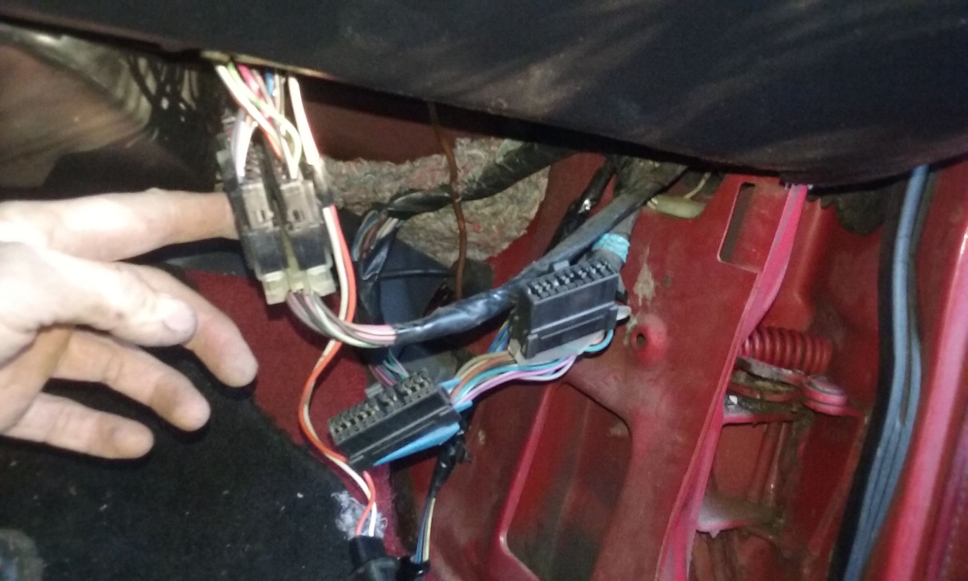

Anyone happen to know what these wires go to and if I can get rid of them as well?
I think these are all thats left holding the passenger side loom in!
One set is tan/blk, light blue, and purple'ish. The other set is blk/wht, tan. Both sets come from passenger side loom and appear to go behind then engine somewhere.
These two are grounds and come from the passenger side loom.

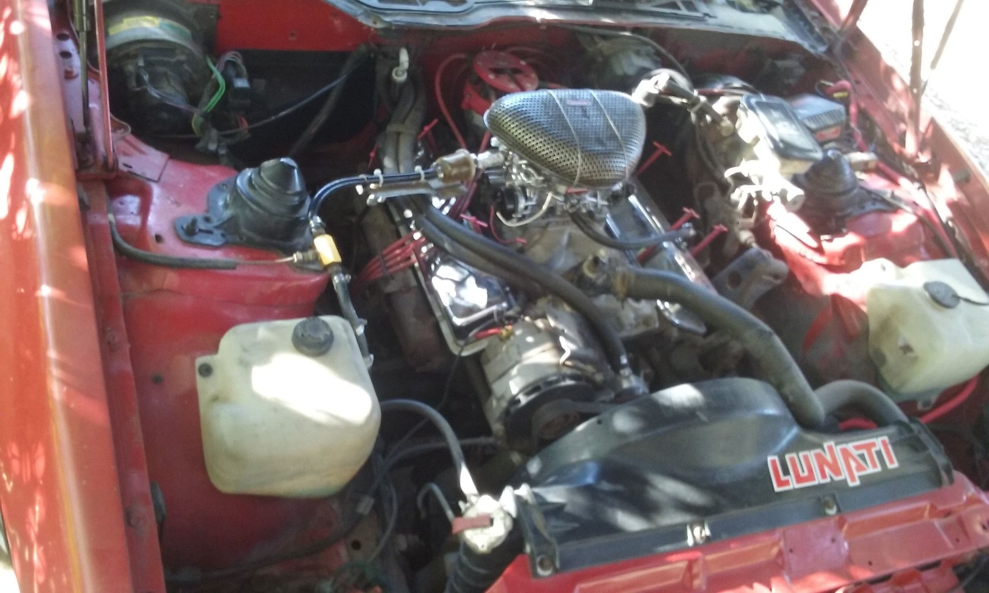

Think I got it figured out...though I haven't tested it to see if everything still works because I need to drive 40 miles to get a battery. ;-)
Looks loads better and frees up alot of space.
There were two connectors under the dash coming from the driver side which connected to the ECM wire loom. I disconnected those but have no idea what they do?!
After removal

More Better !
P.S. IMO ----> you should replace the air cleaner,... almost anything is better. Those things have a real bad REP(utation).
This, and lose that plastic fuel filter on the pressure side of the fuel pump, When it breaks, plan on instant fire. If you are using a mechanical pump on the front right side of the engine, put the filter on the suction side of the pump. If you have an electric pump, cut the steel line somewhere in the rear, flare it, and put a good metal filter in back by the tank.

And those hideous valve cover T-bolts.
Other than that, looks pretty good...

Thanks guys for the input/suggestions!
Air Cleaner: due to hood clearance issues at the time it was the only thing that would work. Switching to the performer manifold helped but I plan to go to the air-gap intake or similar...regardless, I did order a cheap mr. gasket 2" cleaner for the time being until I can figure out a new hood or mod mine to fit my plans for the motor ;-)
Fuel filter: funny coincidence, my new glass style filter just arrived today. I swapped my mech pump for a 110gph electric(mounted near the tank) many years ago. I have a standard filter preceding the pump and will now use the new glass filter at the carb. I will order up a metal filter for the one the before the pump.
Valve cover t-bolts: I know...lol! I was young and thought they'd help keep me from over tightening my valve covers - that was 20 years ago. I will go back to the standard nut style.
Thanks so much for your input guys, really appreciate it!

The real problem IMO is where the fuel lines are. It's never a good idea run a fuel line directly over the exhaust manifold. ( even the factory line ran to the front corner of the block and up the face of the engine into the front of the carb. ) While it's obvious that an attempt was made to protect the fuel lines from the heat & damage,..... You should probably re-work those fuel lines for safety-sake. ( rubber fuel line is 'safer' over the intake manifold than it is over the exhaust manifold ! ) Glass fuel filters are 'cool' cause you can see into them, but there's really no need. I've used glass fuel filters several times in different cars over the years and NEVER had a problem, but honestly; why risk it.
When your ready to change the filter ( or sooner ), it's not a bad idea to have a metal replacement filter waiting as well as a plan to re-route the fuel lines.
