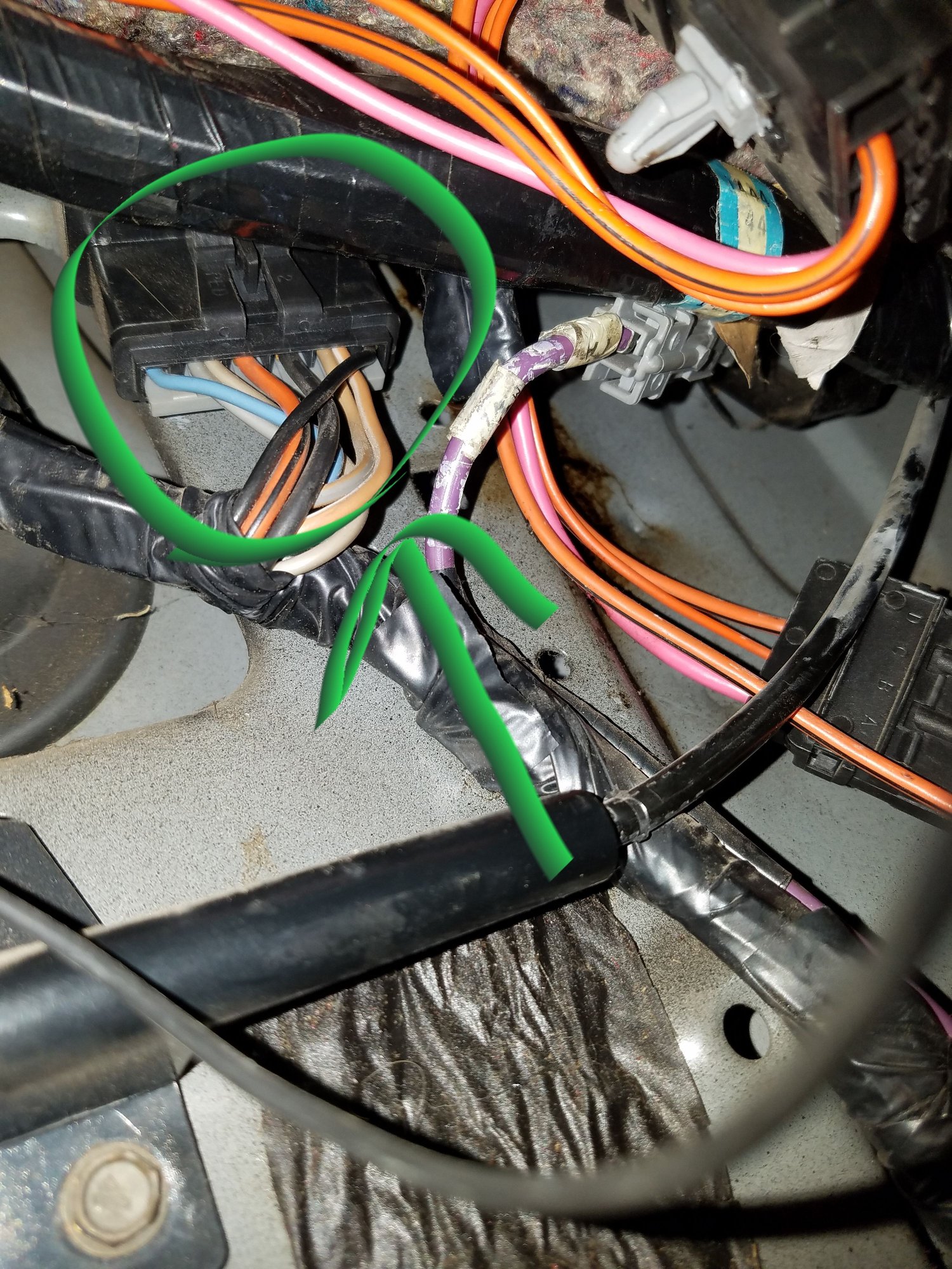

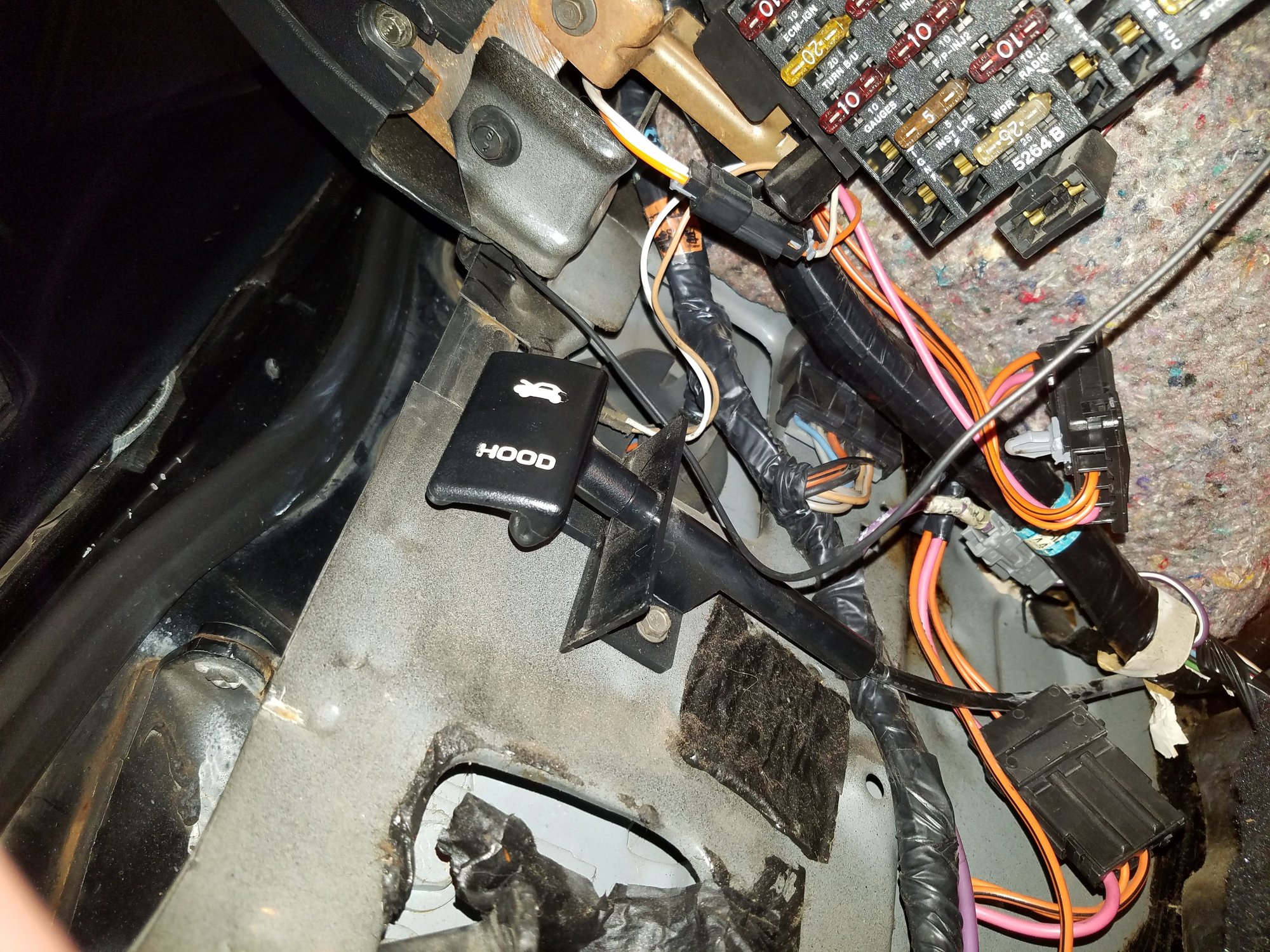

I dont see a main connector here under the kick panel. It goes straight to the fuse block.
I pulled this loome apart and no connector, i apparently dont see it.

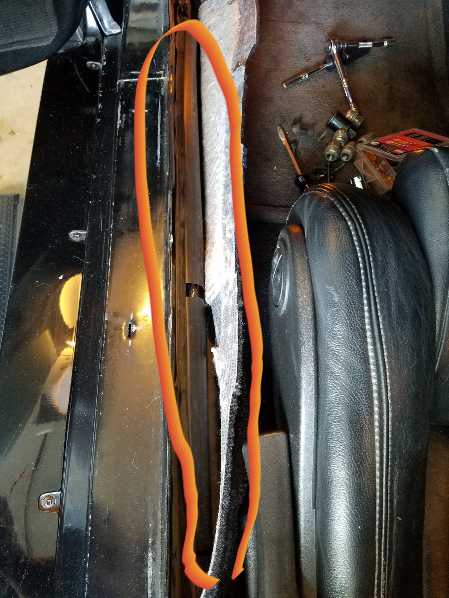

Re: Taillamp wiring harness.
That's not the kick panel, it's the rocker panel. The kick panel is next to your shins when you're in the seat; in front of the door, down low, below the dash.

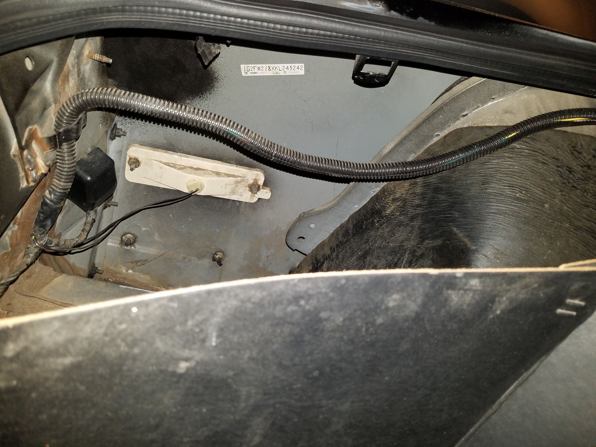

It's a connector at the back of the car on the driver's side. Open the locking storage compartment and feel around behind the cardboard 'box'. Technically it's clipped into an anchor snapped into the body, at the moment I can't remember if it's clipped near the top or the back, either way it's around there somewhere.
Old Apr 26, 2020 | 08:06 PM
tunedport77bird's Avatar
Joined: Jun 2009
Posts: 48
Is the one you are talking about? I unplugged it, turn signals and brake lights work with it unplugged. Still popping fuse.

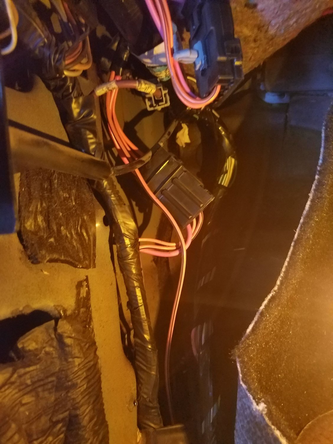

From: Salina, KS
The bundle in most of your pics is the power accessory harness for the locks, windows, that ****. The harness that goes to the fuel pump and the tail lights is the bundle that runs down against the firewall and toeboard.
GM quit connecting the "body" harness behind the driver side Kick Panel in 87 I think. Starting in 88 the wiring changed and the "body" harness was incorporated into the Dash harness. The plug your looking for is behind the rear seat "arm rest" plastic panel; this pic is an 88.....
John, that's where I was thinking it might be! Thank you!
Old Apr 27, 2020 | 07:48 PM
Joined: Jun 2009
Posts: 48
tail lamp harness was good! Found the guilty culprit, a beautifully blown back up bulb!
