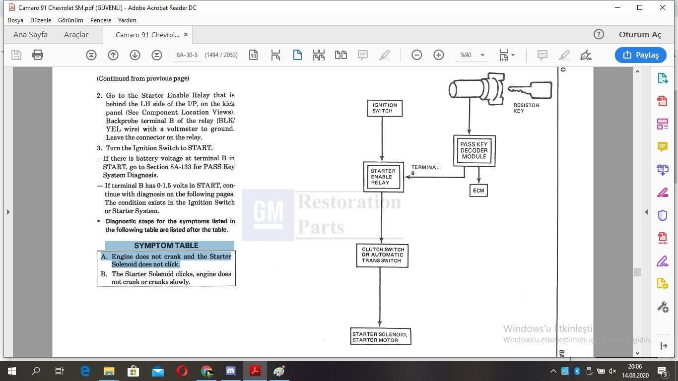

I know that, technically speaking it resides at one of these: ignition switch, starter solenoid, starter enable relay, automatic transmission switch, pass key module. I hope that the (hot engine/no crank--> cooling for 15-20 min/ perfect crank and start) symptom can point out to the exact component without going through the diagnostic process of checking each one.
Can anyone point out to the faulty component with a fair amount of certainty please? Thank you in advance for your attention and time

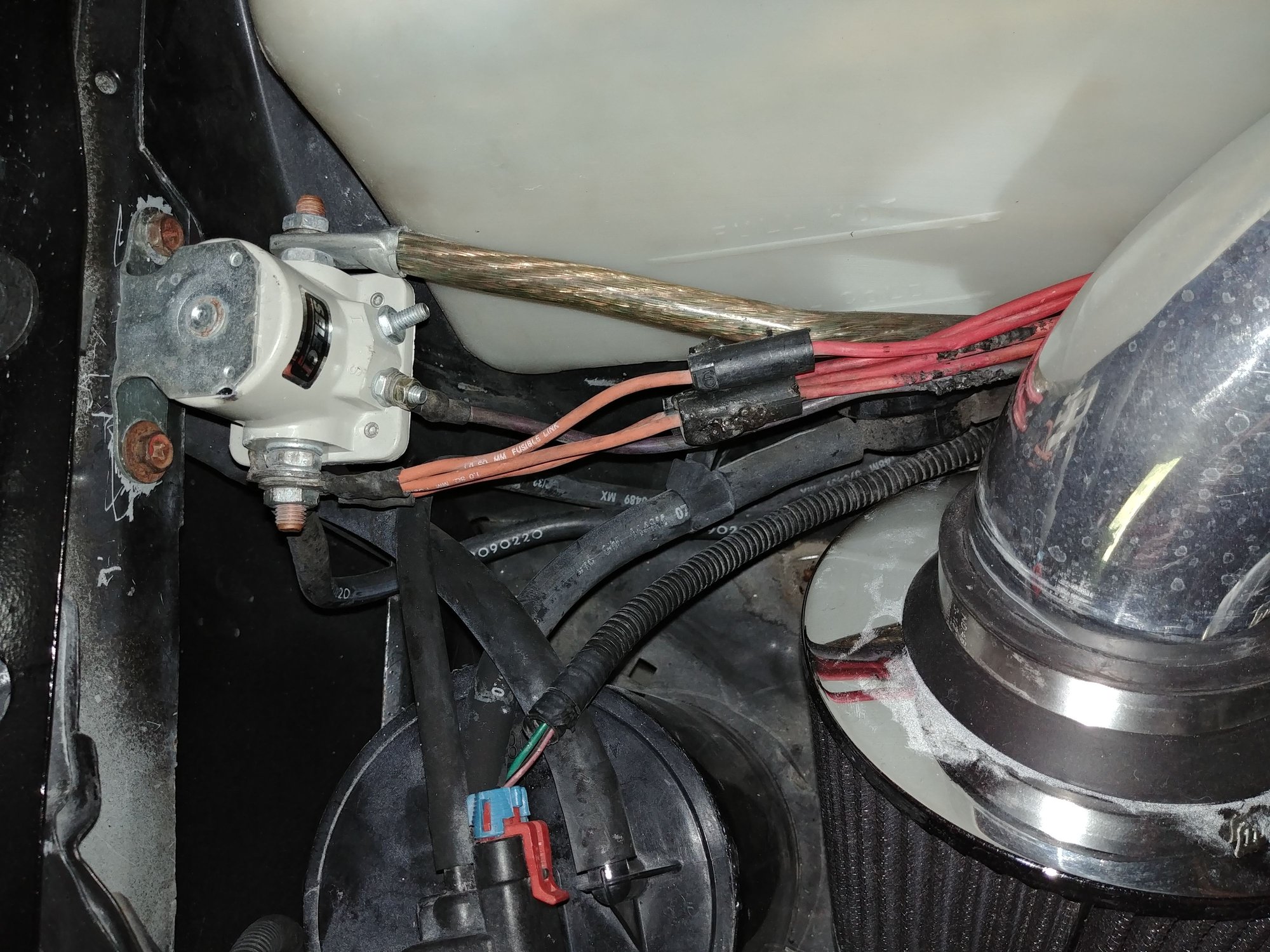

I had a very similar problem. I did the heat shield, multiple starters etc...then i installed the ford solinoid, I rerouted the stock wiring harness(without modification) to the solenoid then i added a Large cable from solenoid
to starter and jumpered the small "start" terminal to the larger terminal at starter.
Now all is good and no issues at anytime with starting..........
Make sense. I'll go with the least expensive approach first and wrap the whole thing with an aliminum heat cover and fix it in its place with plastic cuffs. If the problem is the heat absorption, there is a very good chance it will solve it.
