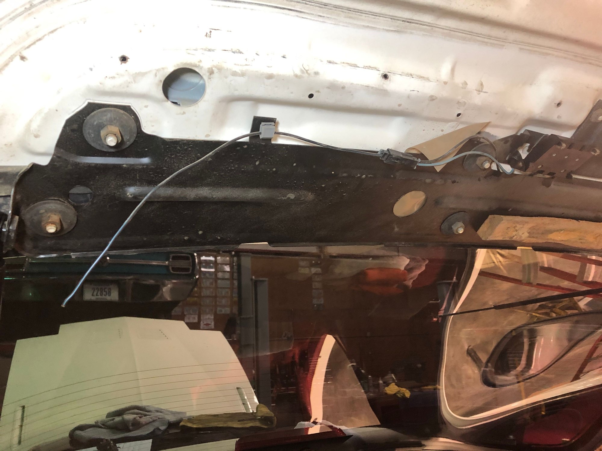

Pictures attachec
Picture of upper hatch

That's the high mount/3rd brake light for sure. That might not be the original hatch on the car and why the color of the wire is different. That should be attached to the wiring for the bulb for the middle light. What is the problem exactly?

I found the problem. I am missing the connection that is attached to the rear window Glass. The power wire that is cut connects to this connection and the black wire from the connection connects to the rear left hand strut connection at the trunk end. Now I have to find this piece and attach to the glass.
