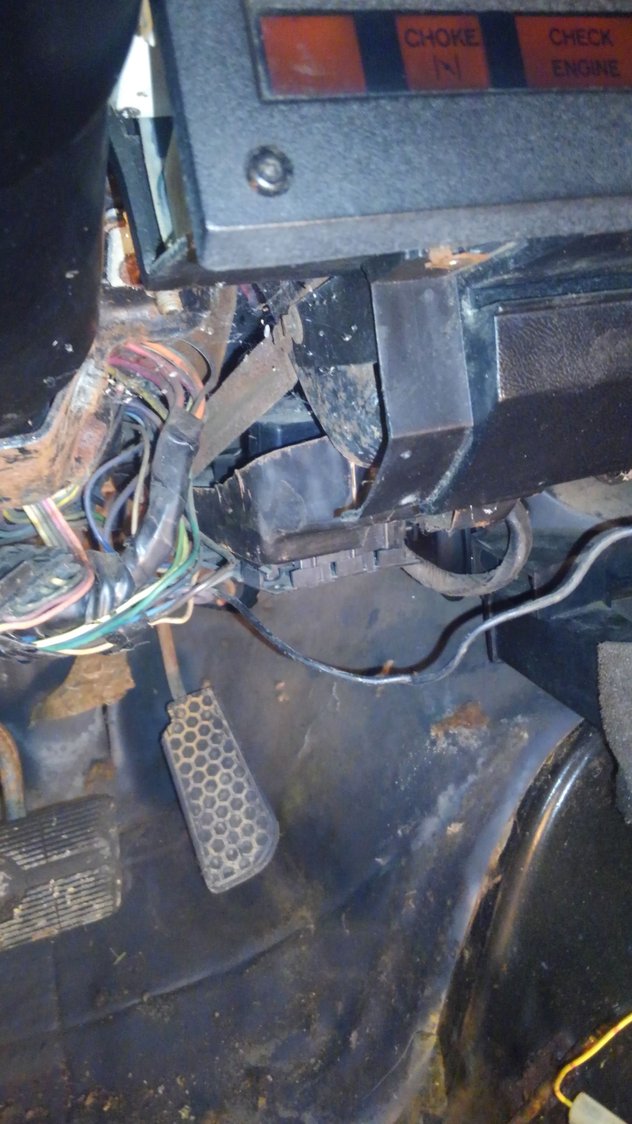

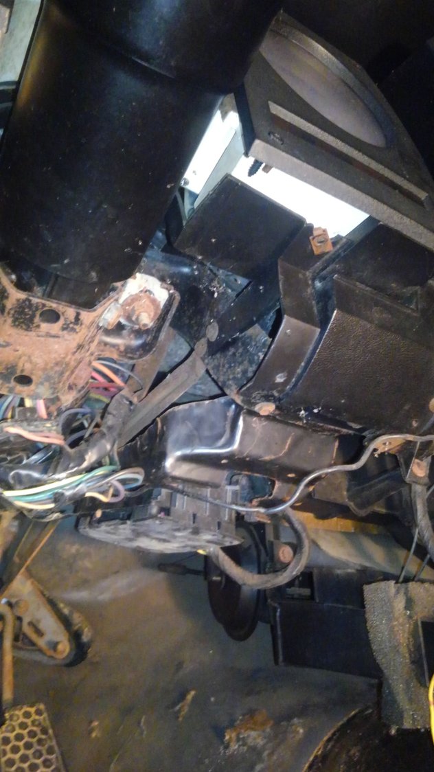

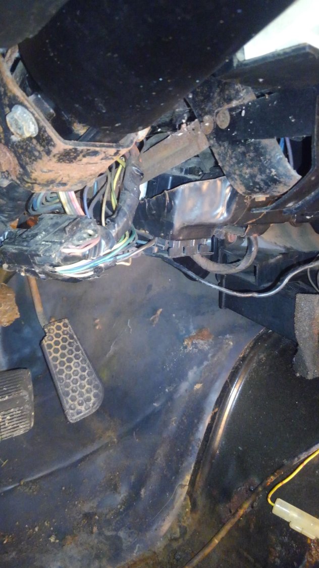

No Aldl port. That's right. None. No wires. nothing. I'm going out to take a picture to show you

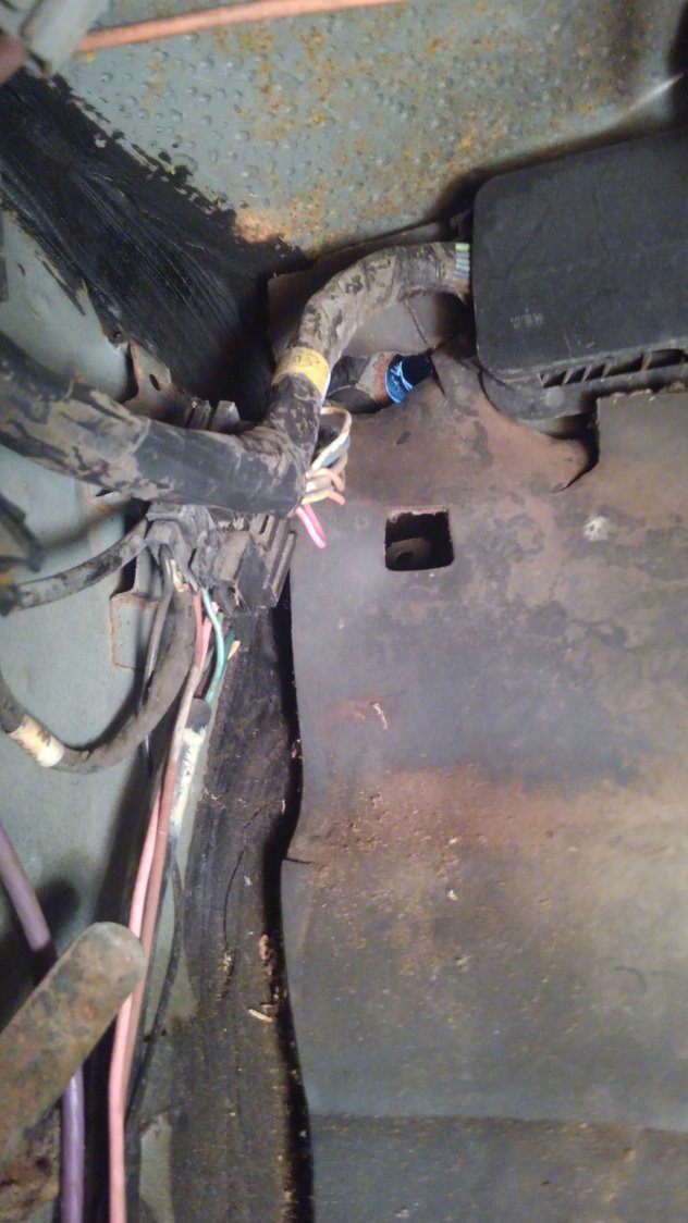

I've looked and followed the wiring. This is all I can find

Oh. It's a 85 camaro with the 2.8. is it possible it came with out one. No sign what so ever.

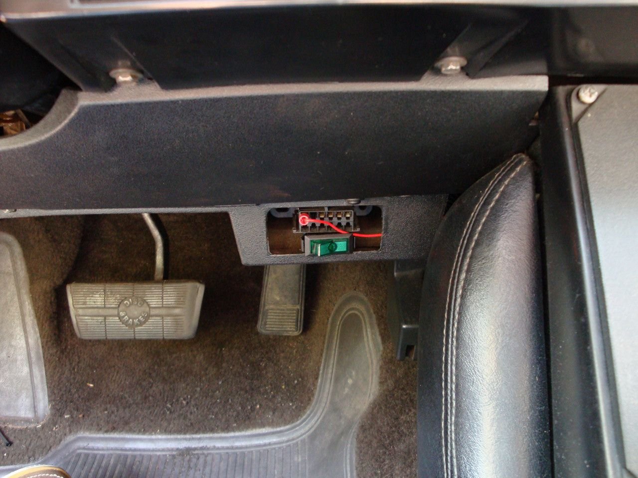

The car definitely did have an ALDL port...
It could have been removed or relocated.
It should be to the right of the steering-column, shown in the image below:

That’s one way to do tcc lockup 😆
have you looked for the wires they run through c207 ?
