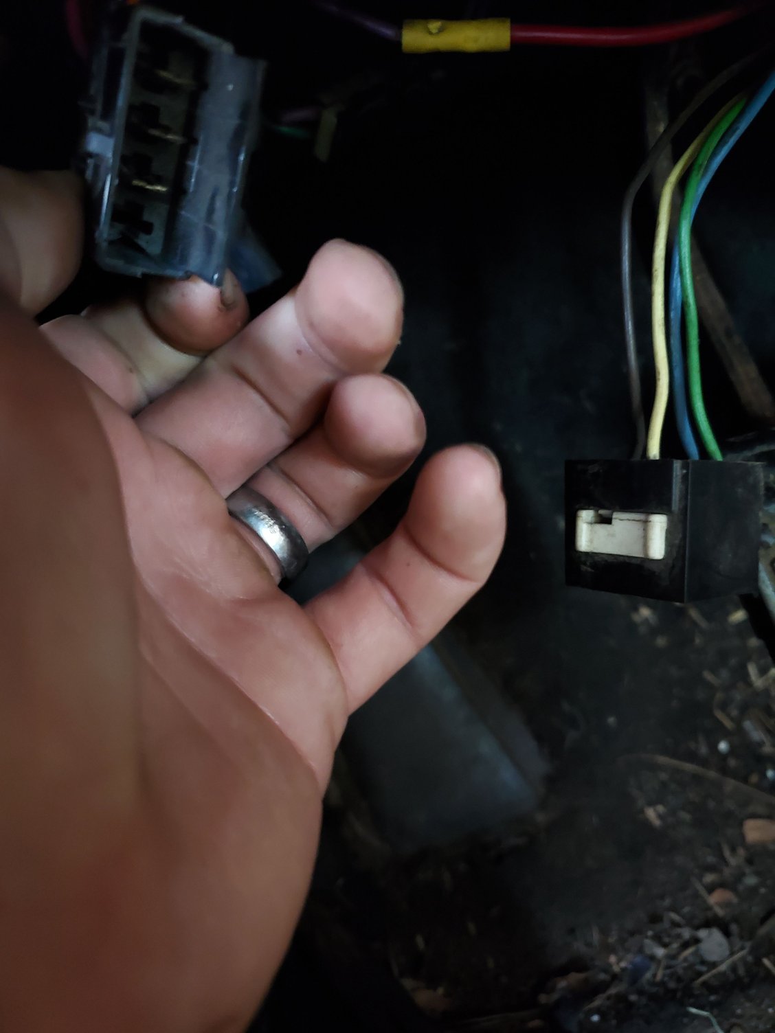

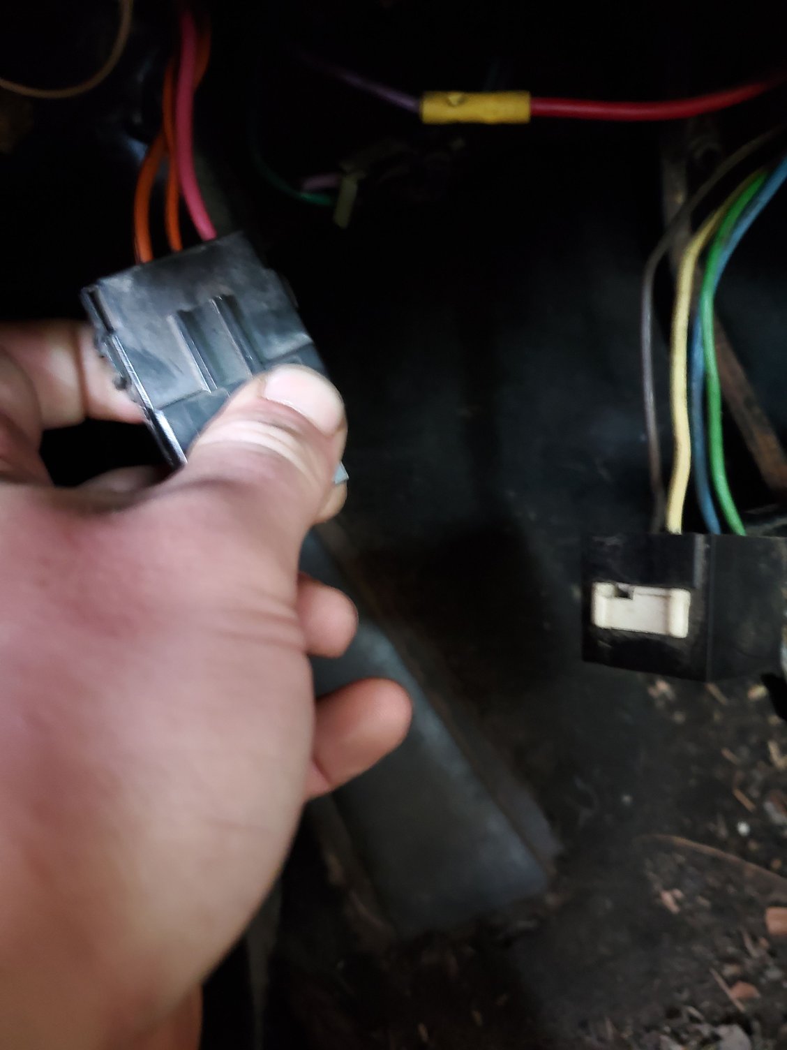

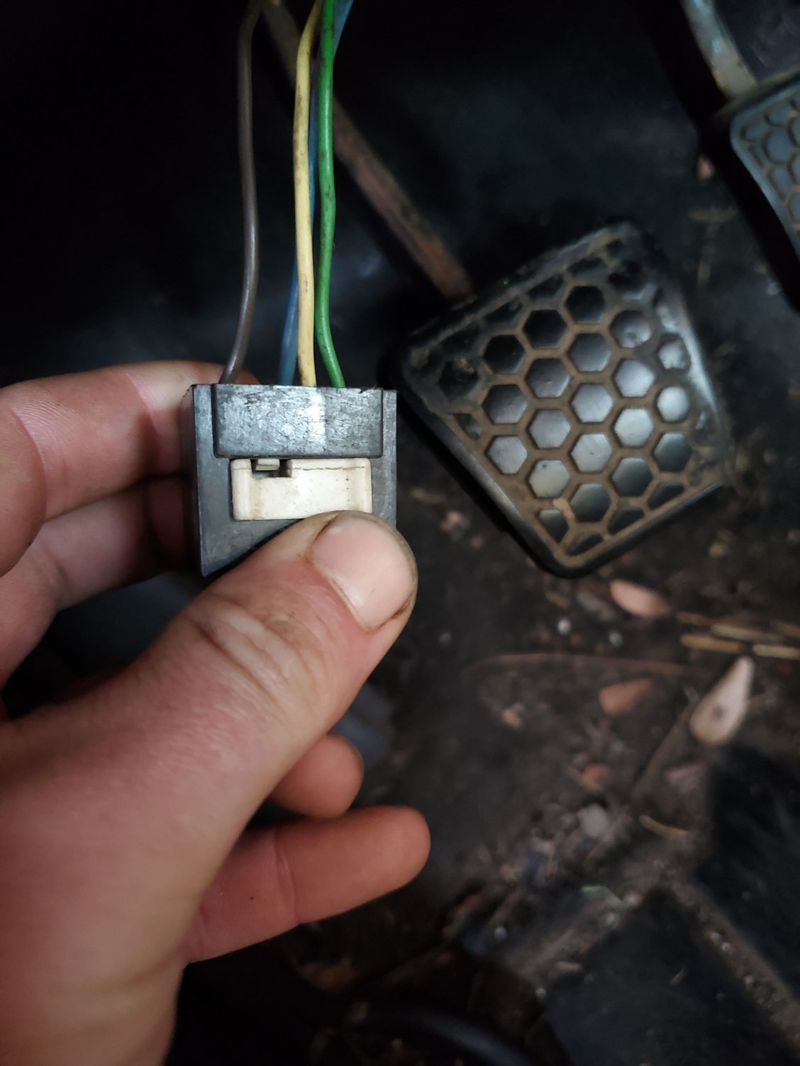

91 camaro have a single orange wire running passenger fender its has no end installed.
it is live and has 2 connections in series to extended wire.
also a large harness under the dash which has pink,orange,orange/black.
car was converted to carb before I received working on a few issues.
thanks in advance
I believe it was a stock v8
current issue are no high beems,horn,wiper motor and coolant fan.
if anyone know off hand what color is the coolant temp switch mine has no connection but still I'm head
relay connection under dash 5 pin with only 4 used terminals[found a few post stating its fog light relay]

I been look my main concern what orange wires supposed to be for . Other I added for a possible quick answer since I already making post.
would fan switch wire be installed in ecm harness where orange is ran,
gonna trail it down off relay next Chance I get
