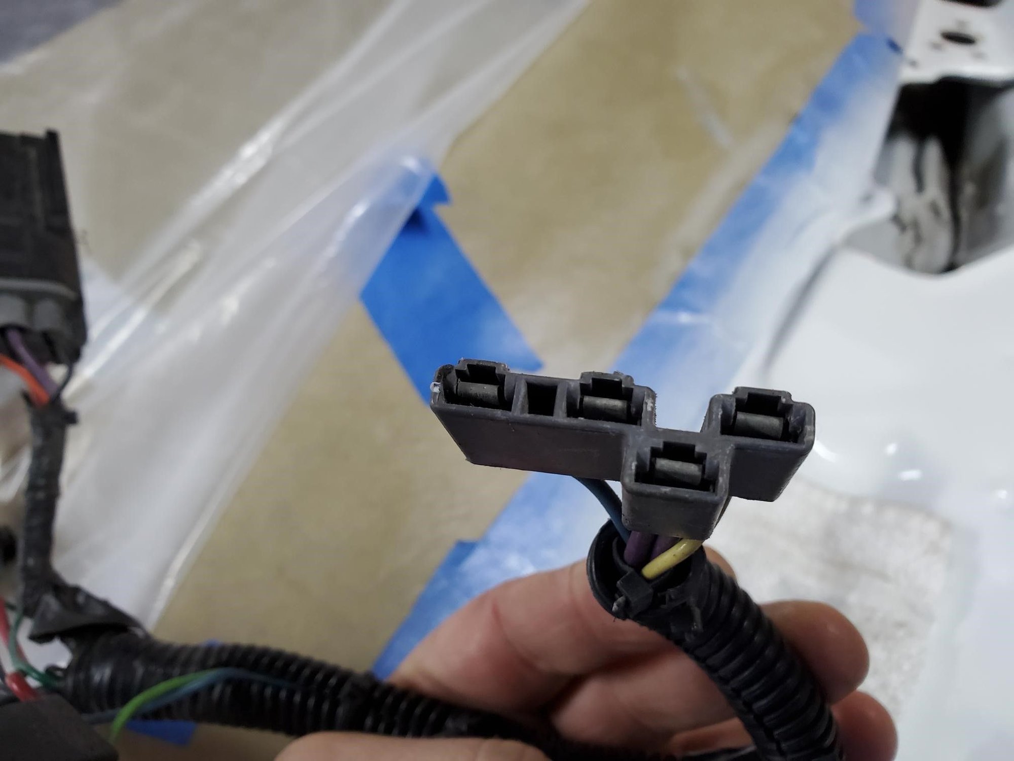

OK just running a heater.. what Can I remove from this set..I know the heater speed Plug (Gray Plug) far right..
and plug far left is to blower motor purple & black wire..
now..I think the rest I can delete? as it was to AC?
Keeping this plug below. AND the plug above with the orange seal Left side of pic. is the relay center top all part of this..(thinking so)

fixed got it down to 1.Relay..2.Fan Power..the the 3.fan speed Resister..A/C plugs are removed..
