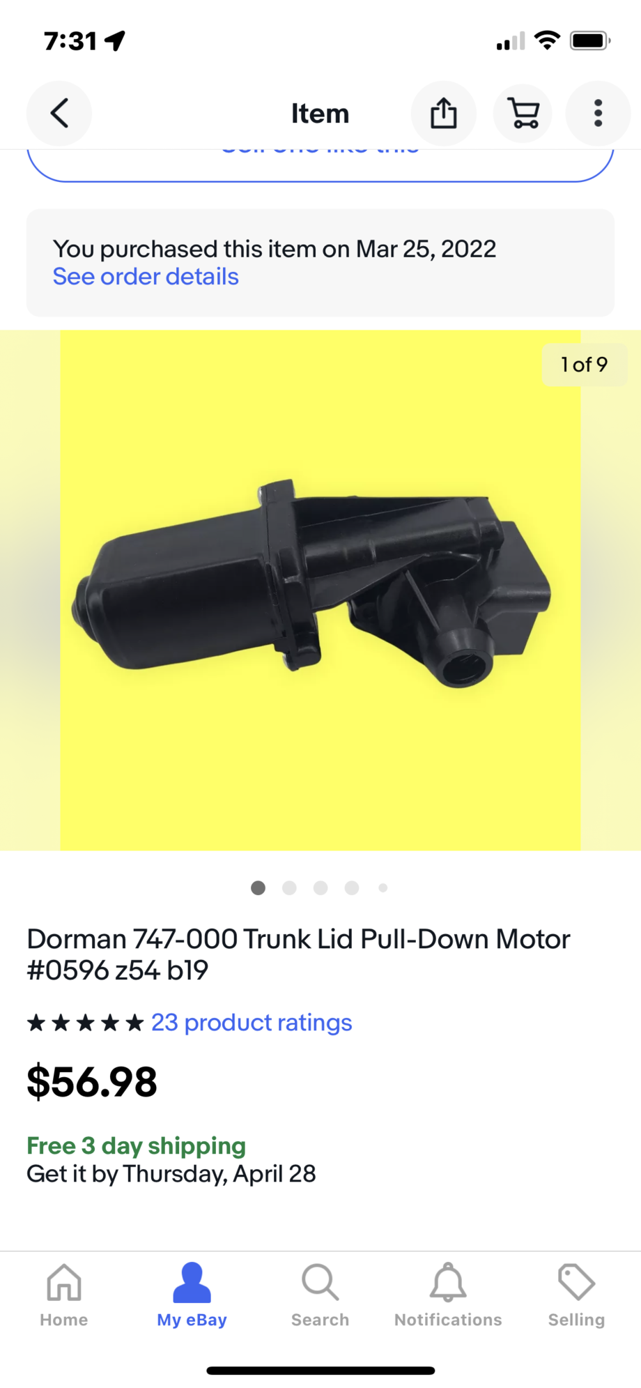

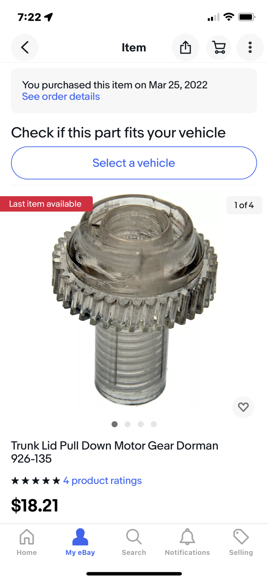

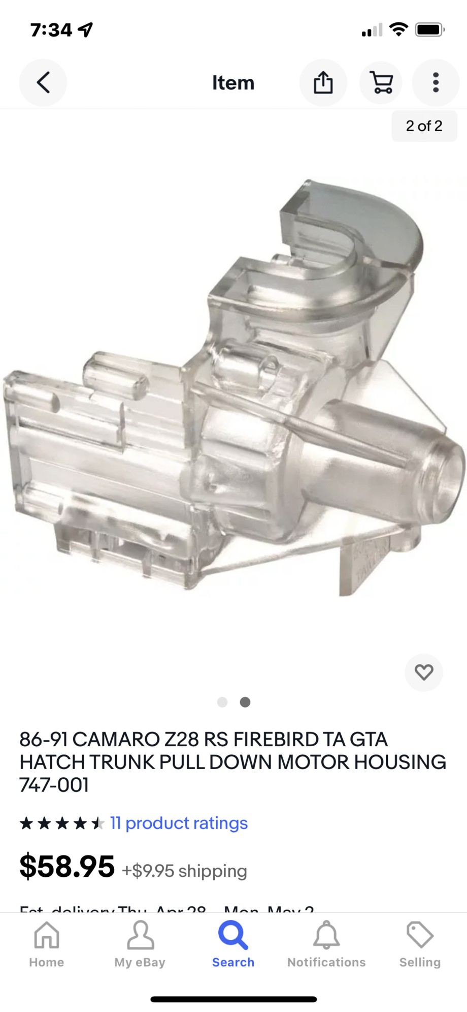

If the motor just keeps spinning the gear nut probably has some teeth broken off from closing the the hatch to hard or the plastic just gets brittle, as already stated the motor housing which from the factory is made out of the same material as the gear nut is more than likely cracked in multiple places allowing the gear nut to lose contact with the worn gear of the motor. Good news sound like you’ve got a good motor, bad news is the whole hatch pull down assembly needs to be disassembled to troubleshoot what’s broken and you might as well at bare minimum replace the motor housing and gear nut.
I just recently completely rebuilt mine with all new parts, I was lucky to find a motor and housing for under $60, usually their $75 - $125
