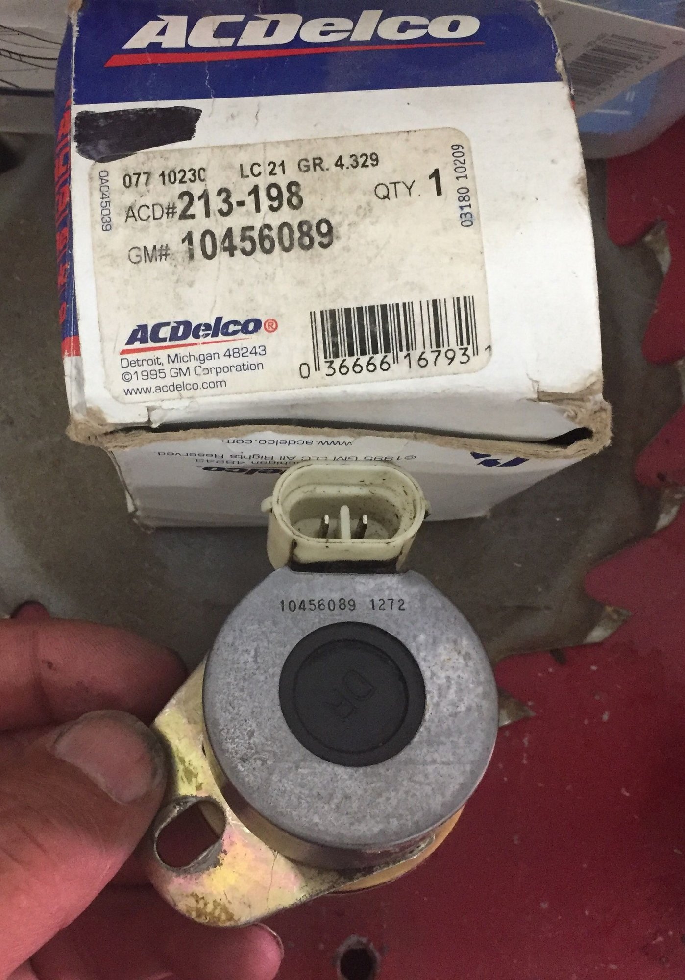

ACDelco 213-198 if you need I have a new one gm 10456089. Located on the transmission tail housing.

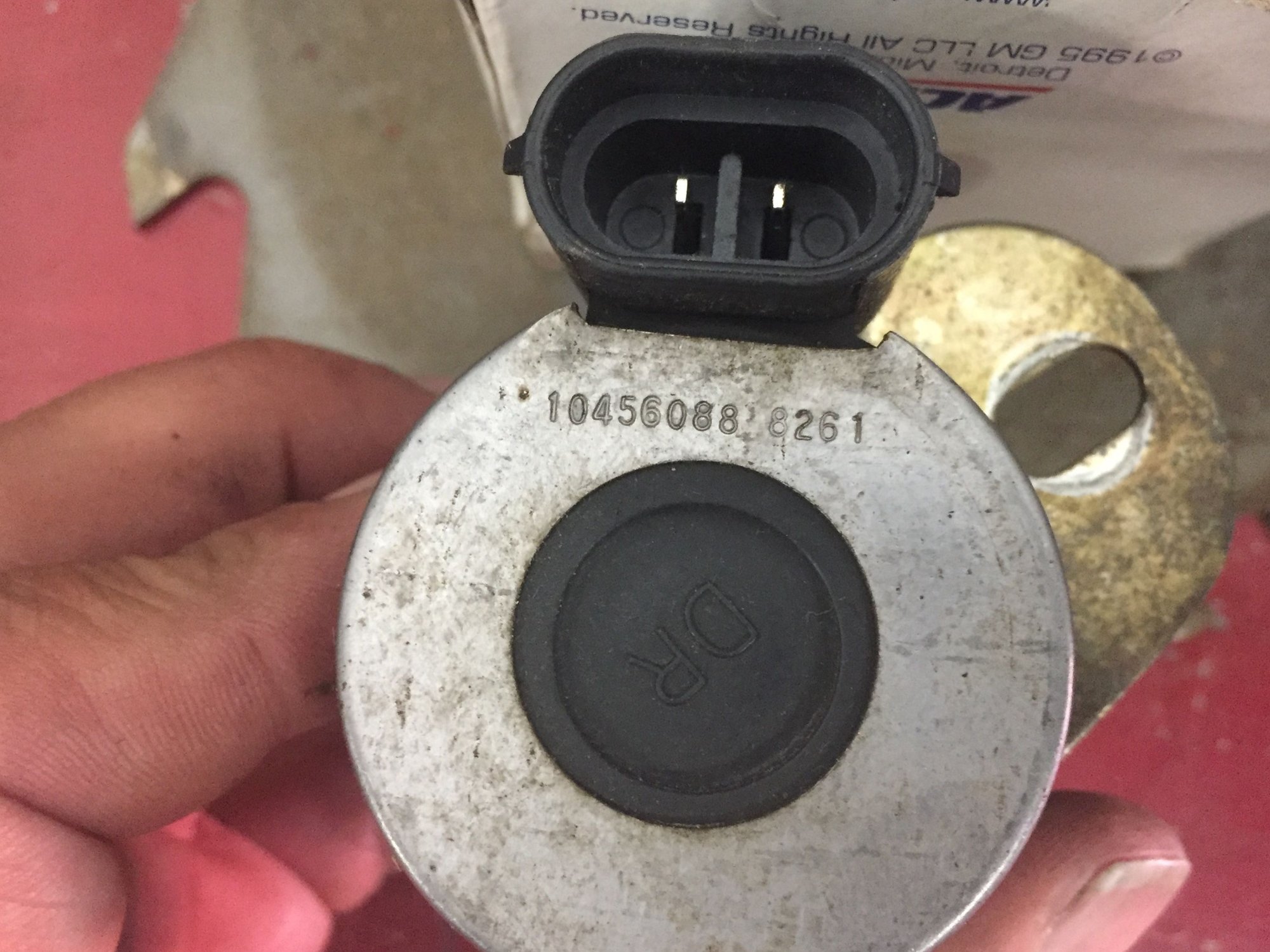

bummer , it’s not new have a like new 10456088 gm depending on gear ratio
you can drive and test acv at ecm b9 and b10 purple and yellow wires.
