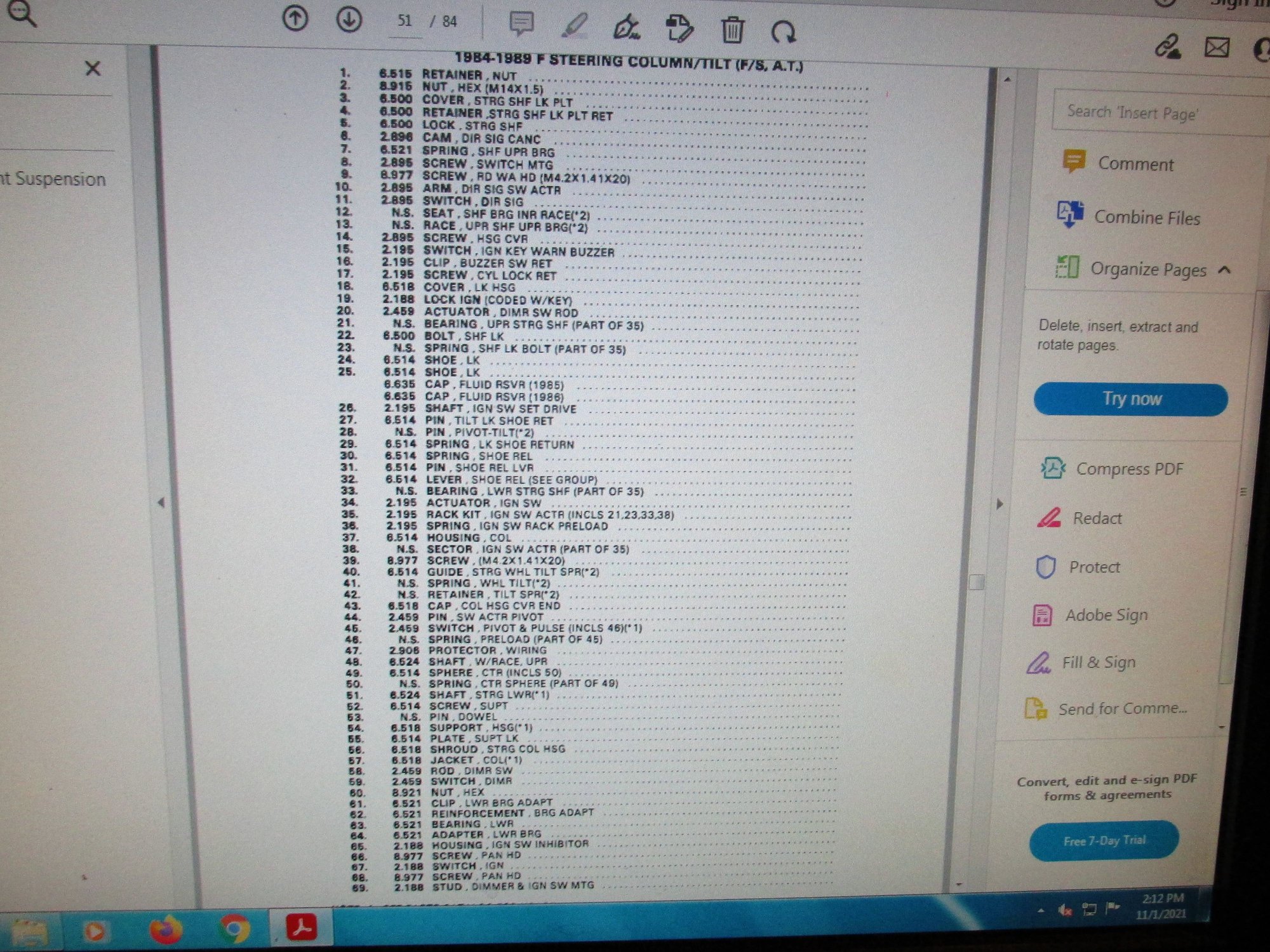

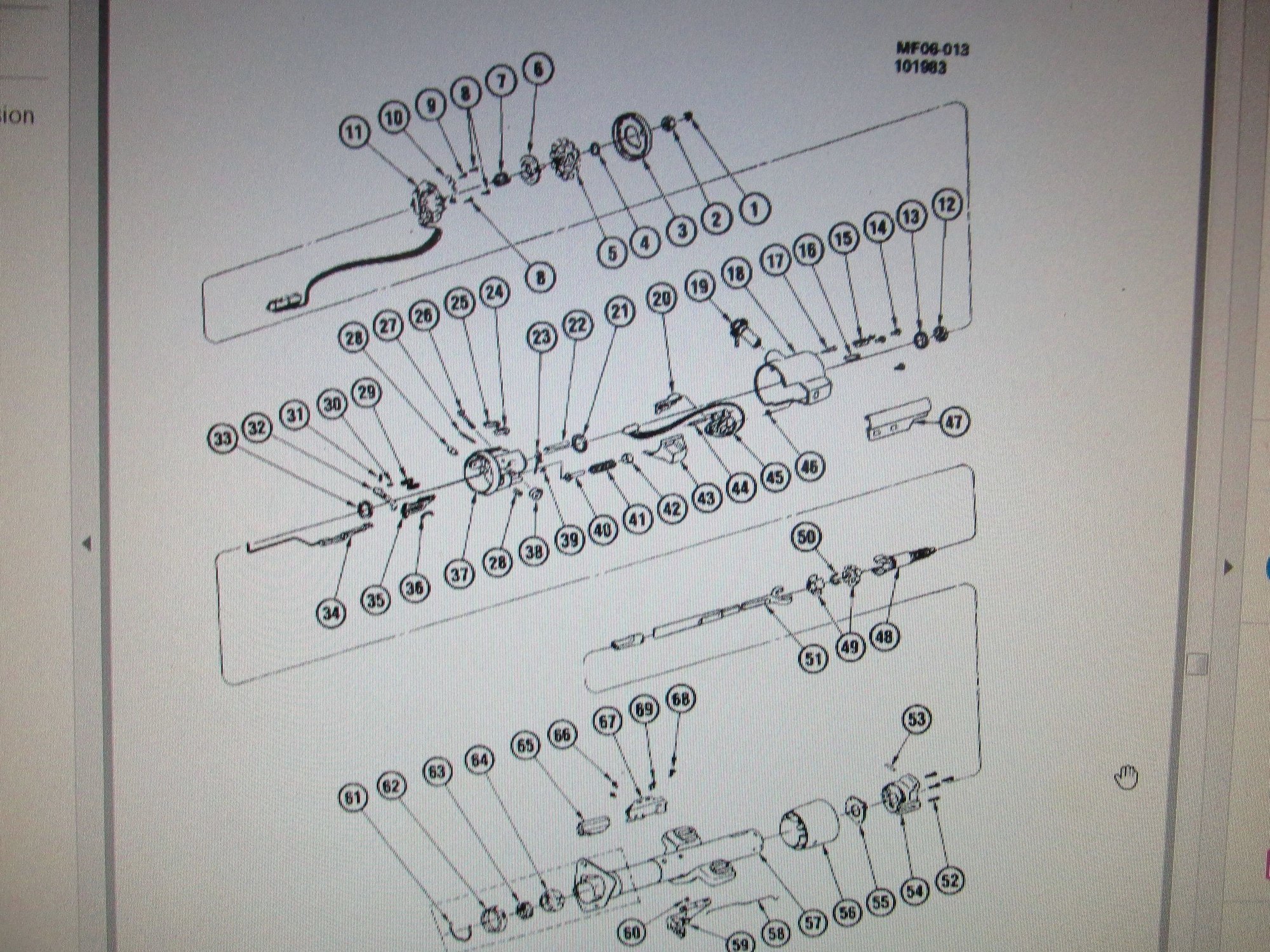

Maybe this will help you out.Standard and tilt steering columm
