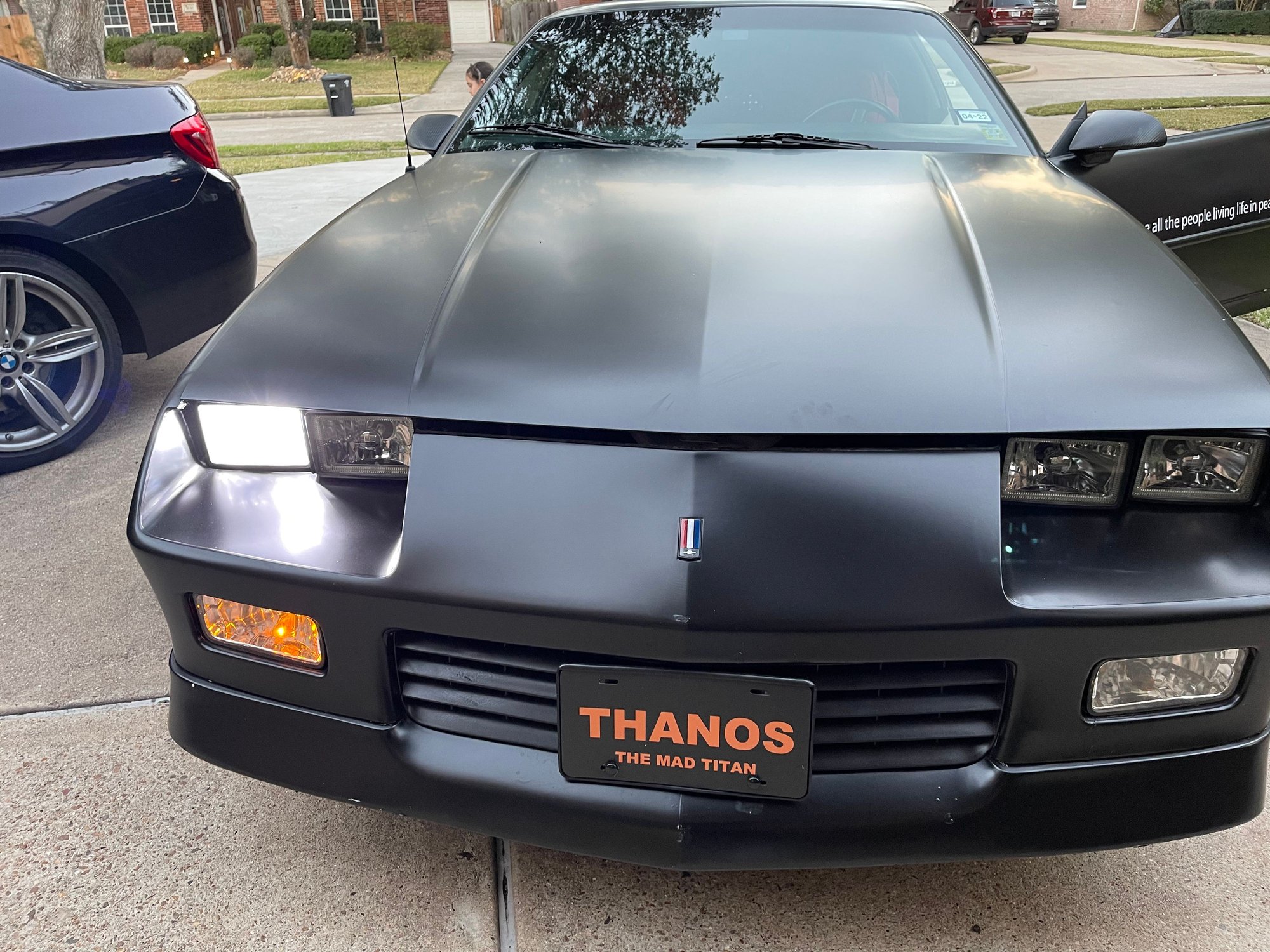

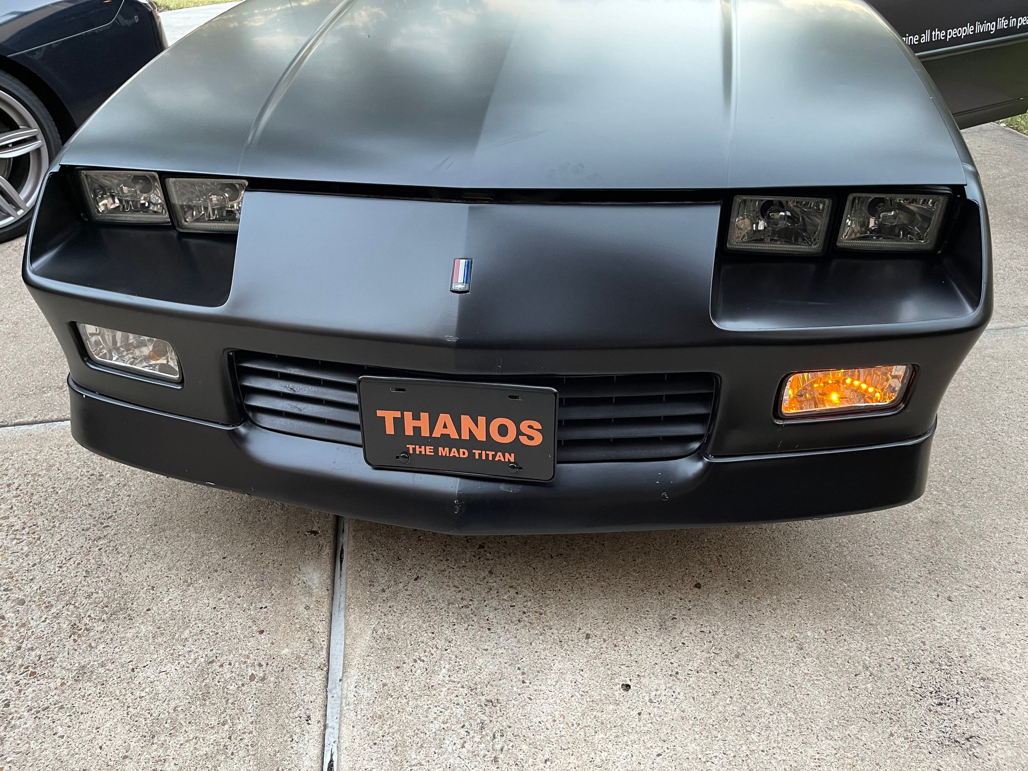

Hey guys, just had this issue on my 1990 Camaro RS V6. Left blinker is not working, staying lit. When try to turn on headlight (low or high beam), none turns on on the left. Right is fine. Also, odd part is the blinker light that was on with the engine running, turns off when trying on headlights. Hazard light works fine. Right blinker works fine. Something is wrong on left side. Also, the windshield wiper stopped working at the same time. Will take to mechanics, but thought someone may have experienced the same issue. Thanks.
