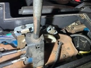

Where physically is the Gear Selector Switch Ground? I do not see a wire/ground in the center console.
GSS

The 6-Terminal Gear-Selector/ Neutral-Safety Switch Does not have a "Ground Connection" Per Se...
For a 1991 Car...?
-10AWG Green and Purple are the In and Out Wires for the Starter Motor.
-18AWG Blue and Green are the In and Out Wires for the Reverse Lamps.
-The Orange w/ Tracer and Black w/ Tracer are the In and Out NSS Wires for the PCM.
